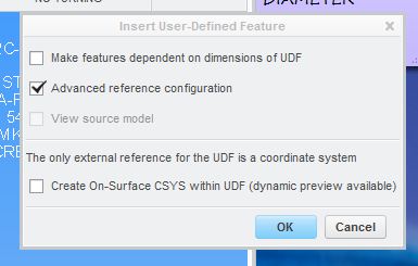

I was trying to import a saved work cell last week, but when I tried to load, it came up with a new screen
Now I tried to tick all of these option one by one and load the work cell, but all I got was this message.

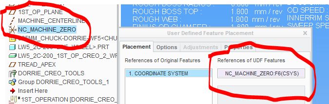

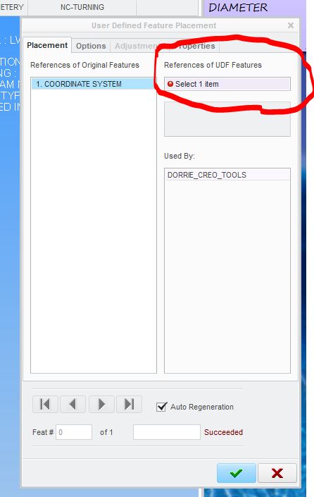

Now we kind of figured it out, we resaved the current work cell in Creo 2.0 under another name and treid to load it again, this time with the option above ticked, I received this box below
then by clicking the box circled and selecting the CSYS as shown below
WE CAN LOAD THE SAVED WORK CELL..
what does this mean, something has changed within work cells from Creo 1/ Pro E to Creo 2, any saved work cell is now useless, so any specials cells you may have created and saved, unless you can open a file with it in place and resaved from within Creo 2.0, can't be used....
