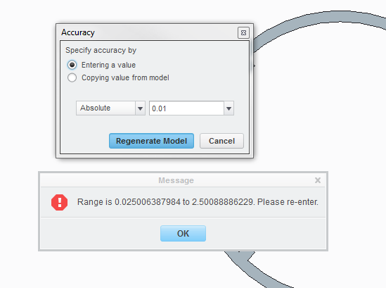

Thanks Chaps, I'm getting there slowly, but not I'm quite there yet.
I have absolute working as an option. The default value was ~0.3. I have tried to enter in 0.01 as suggested (unless I've misinterpreted?) but the following error occurs:
What is this value actually linked to when relative (a percentage of the maximum edge length in the model?) and what is it driving when absolute, please?
Many thanks,
Andy
May 19, 2015 12:43 PM UTC
You may want to use/set the following in your config.pro
default_abs_accuracy 0.01
accuracy_lower_bound 1E-04
May 19, 2015 12:45 PM UTC
My config.pro contains:
accuracy_lower_bound 1E-06
default_abs_accuracy 0.002
Martin Hanak

Thanks again guys. I take it that smaller numbers mean a higher shortest edge : longest edge ratio can be achieved?
May 19, 2015 12:53 PM UTC
As I understand it...
Relative is a tolerance based on a percentage of distance
Absolute is a tolerance of accuracy with no regards to distance applied
