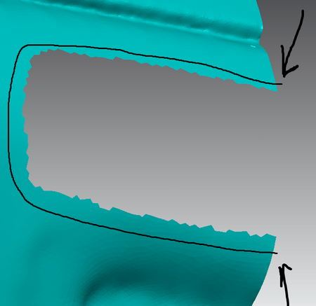

I work on STL data with Restyle environment

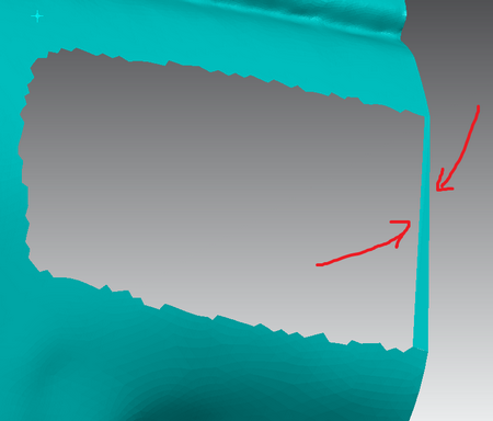

I want to close an open gap(below). Fill hole tool does not work because it requires closed loop(so far I imagine this could be a cause)
I thought I can add faces but, created ones do not maintain the shape/curvature of adjacent faces
How do you solve such issues?

    This is because this is faceted geometry. It has no curvature information to follow.
    This looks like a 3D scan. There are a few scan tools but I suspect they belong to an optional package.
    The best you can do is approximate a patch but it won't merge.
