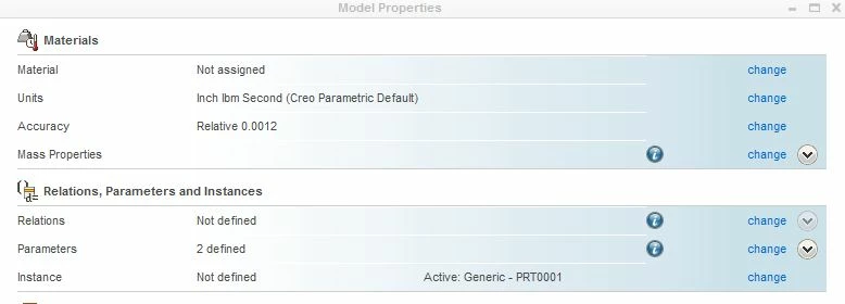

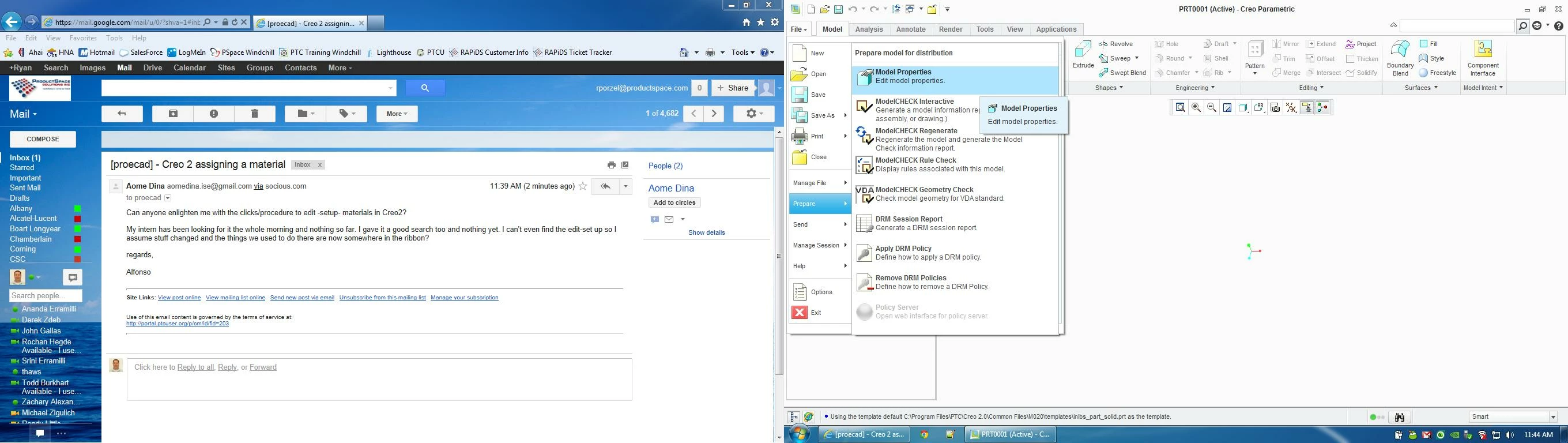

    Please see the 2 attached screen shots. To assign a material, go to
    File --> Prepare --> Model Properties. From there you can assign a
    material. If you wish to modify the properties of a material, select Change
    next to Material. When the Material list comes up, right click on a
    material and choose "Properties" There you can edit the material
    properties. If you wish to create a new one, I recommend going to the
    materials library and doing a "Save-As" on a material and then following
    the above steps to edit the properties.

    That helped. Thanks!... I swear we looked into the prepare menu and missed
    it.
