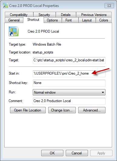

    Mar 10, 2014 4:09 PM UTC
    Those are environment variables. In Creo, out of the box many of those don't exist. You would have to set them in your startup script.

    The two I've hi-lited are there because I set them in my startup script.
    set PTC_WF_ROOT=%USERPROFILE%\pro\creo_2_home\cache\PDMLink_cache\PTC\ProENGINEER
    set PTC_HELP_CENTER_URL=C:\ptc\Creo 2.0\Help\help\creo_help
    PROE_START_DIR
    This is supposed to be the directory where ProE/Creo starts from. That is one of the locations it reads a config file from.
    Not sure this still works.
    I don't use this, I just change it with the start in directory section of the shortcut used to launch Creo. I put the directory under the users profile, so if you have multiple people using a computer, like in a conference room, they will all have their own environment.
    [cid:image001.png@01CF3C40.72A170B0]
    PROE_WORK_DIR
    Obviously this would be the working directory. Before PDMLink, you could use this as another location where ProE would read a config file from. You would only want that if you worked outside of Windchill. But that would necessitate that you had a different startup script for each working directory you wanted to start.
