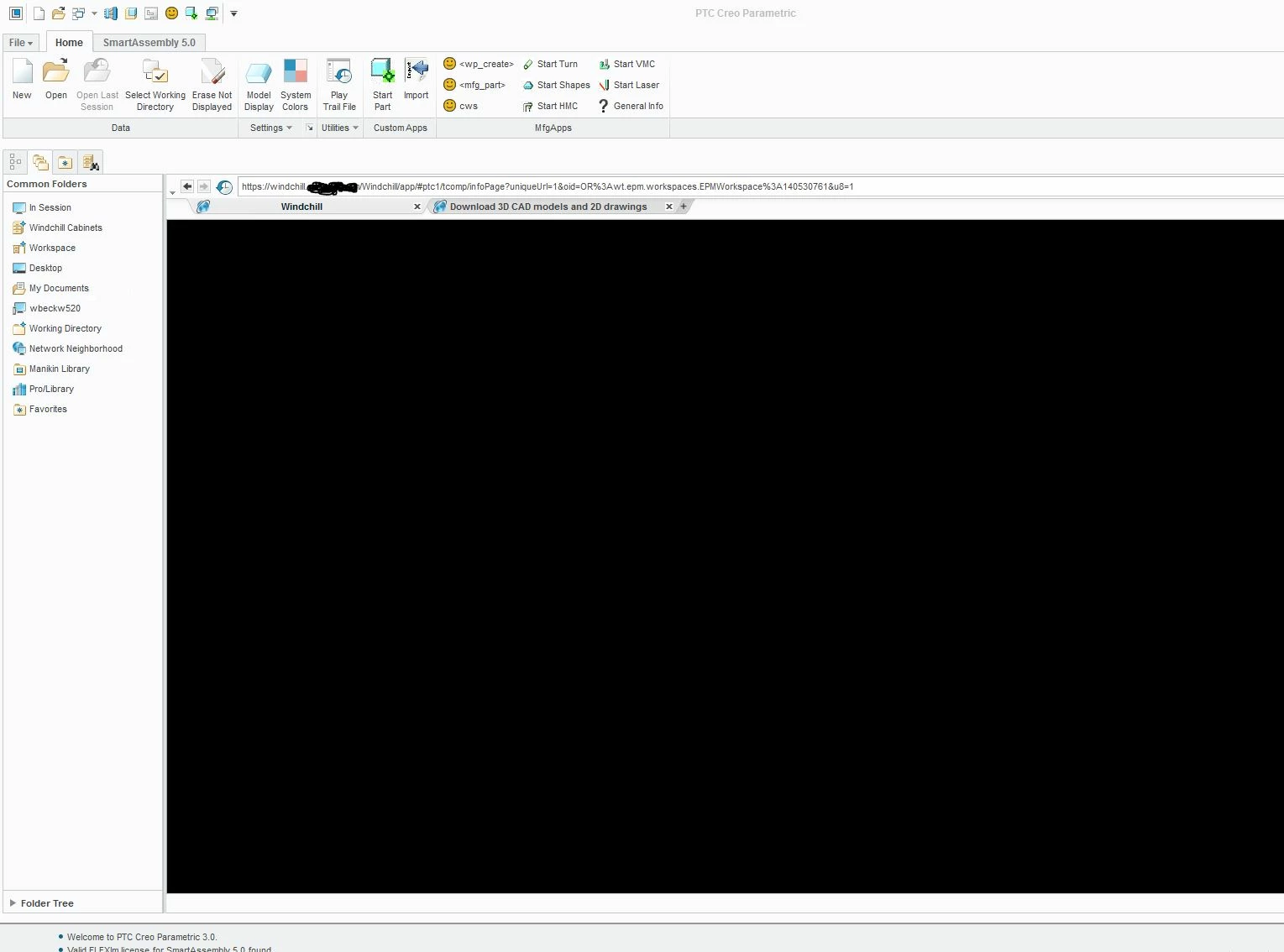

Creo 3 M010 testing......
Embedded browser showing all black. If I delete the tab and start a new one it works fine. Anyone seen this before on Creo 2 or 3? If I do a view source, the source shows what I would expect to see.

    Hey Wayne, I dod some testing this morning and mine is working fine.....

    Wayne,
    There can be a couple things to consider.
    What version of IE or Firefox is your company using?
    Embedded browser has issues with websites that contain flash, use a static
    web page with links.
    Set the config.pro enable_3dmodelspace_browser_tab no

    I am using the new Chrome embedded browser and my video card is Nvidia Quadro 2000M. I have the default landing page for the embedded browser set to
    Oct 29, 2014 2:36 PM UTC
    I have it load nothing. Don't have any problems.
    web_browser_homepage
    slapha
    Oct 29, 2014 3:21 PM UTC
    I've seen it happen in Creo 2, M080 or M100 but it was a bit random. Typically when running modelcheck, but occasionally with Windchill (10.2 M010). Though I haven't experienced it in Creo 2 M120 that we're on today.
