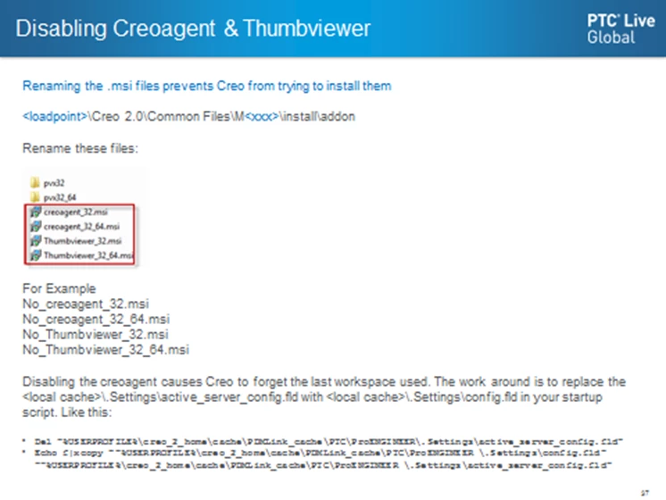

    • Disabling Creoagent & Thumbviewer
    I do this on diskless systems with no internet connectivity
