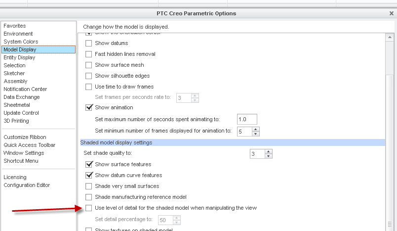

So, we recently had a user that receive a new workstation (HP Z440) with up-to-date drivers and BIOS and a factory installed AMD FirePro W2100 GPU, which was later replaced with an NVIDIA NVS 510 2GB GFX GPU.  Since the new graphics card was installed, the user is not able to work with large components without encountering lag and pixilation of the on-screen image.
I was wondering if anyone has ever experienced this or has any ideas on what could be wrong?
Any advice would be appreciated.

    My first recommendation would be to upgrade to the latest video card drivers. That usually solves a large number of problems.
    If the "pixilation" happening during spinning, if so, there is a config option for level of detail that simplifies smaller parts to make the model spin faster.
    You can easily find that under file options model display. Uncheck it and try spinning the model.
    It's also can be turned off in the editor LODS_ENABLED NO
