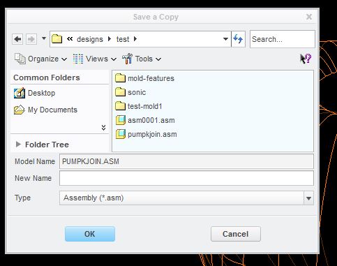

is the "save a copy" window in assembly, diagonally scalable in the latest maintenance release?
Oct 25, 2013 2:18 PM UTC
this one?
