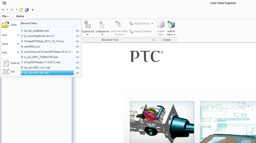

Creo Viewe Does not show ,,save as,, option
Hello all,
Any solutions to this challenge ?

    Open your file first...then see if you have the option. (there is nothing shown in the graphics screen in your image). I have Creo View 2 M040 and all the Save As options are grayed out if I don't open a file and just open the session of CV2.

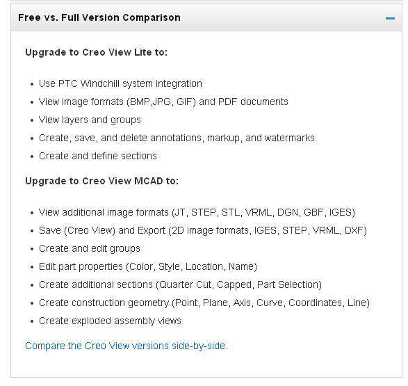

    Of course, you must first open the desired content. But if you use the express version and want to save the file, then you need to upgrade program (http://www.ptc.com/products/creo/view/express/#5).
