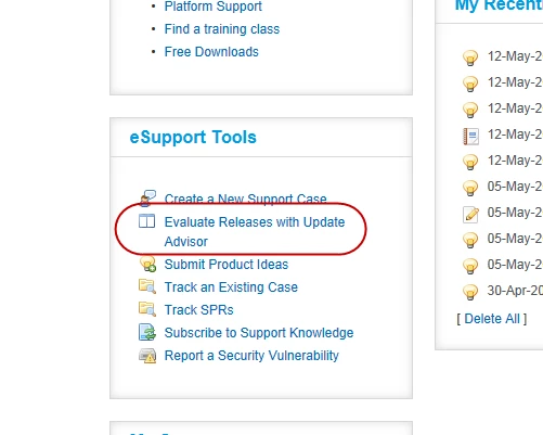

    Is the list of fixes between builds still available? If so, where is it?

    May 14, 2014 7:30 PM UTC
    Under eSupport Tools on your PTC support page.

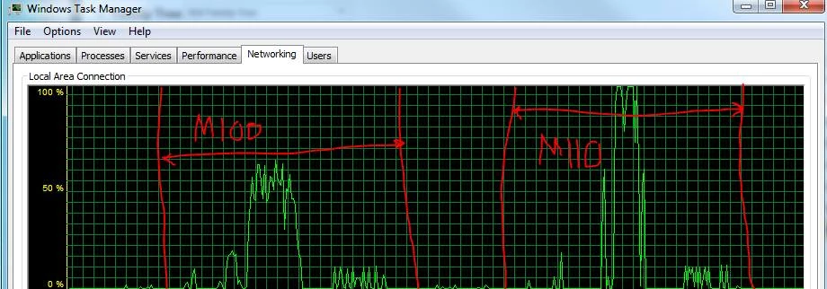

    May 20, 2014 10:41 PM UTC
    Go to M110 if you are connected to Windchill and depend on Creo calling for the objects on the fly. For some reason, M110 is able to utilize 100% of the network which has given us a 20% improvement in opening files(initial testing). Thank you PTC!
    [cid:image001.png@01CF737D.CA1D2E50]
