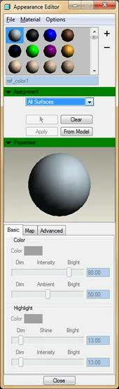

    Is the option to clear all "surfaces" still available in Creo 2.0? I see an option to clear all appearances and clear by selecting individually?? I want to keep the color assigned to the part but want to clear areas of the parts that I previously highlighted in a different color. I do not want to go back and have to click the all individually surface patches to now clear them.

    Dec 10, 2012 8:01 PM UTC
    WF 3 gave this option. Wondering where it went?
