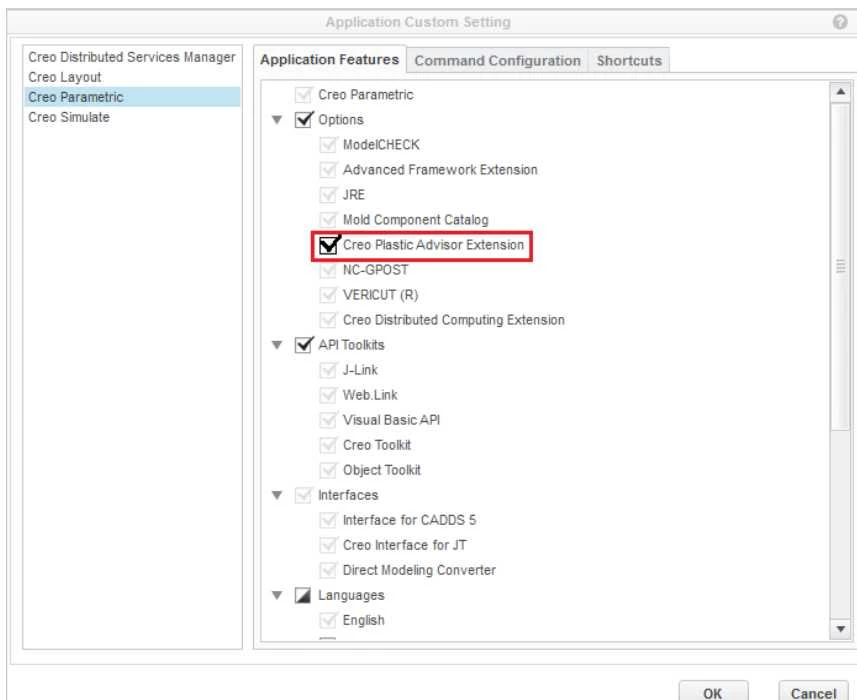

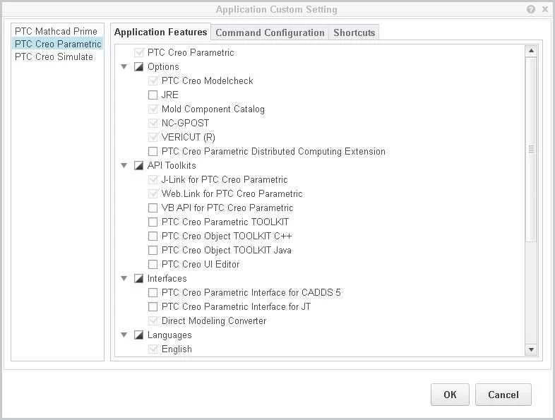

Creo3.0 Plastic Advisor
I can't find how install Plastic Advisor with Creo 3.0, what is the trick?

    Aug 11, 2014 2:56 PM UTC
    Leonid
    Creo 3.0 M010 should see the release of the new Plastic Advisor built on Moldex technology. You will be able to install and test it at that point.
    The old Plastic Advisor capability is not available in Creo 3.0 F000
    I hope this addresses your question
    Thanks in advance
    Paul Sagar
    Director of Creo Product Management
