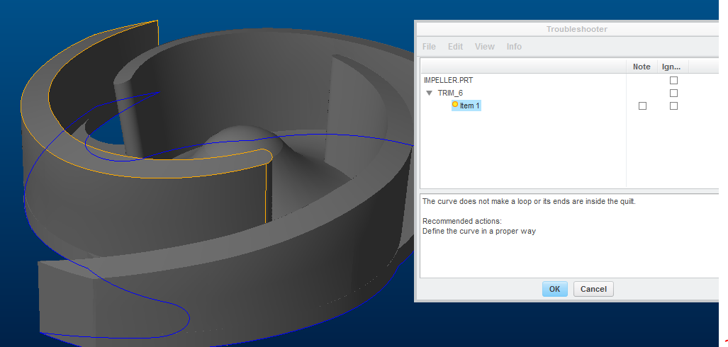

Curve Error
Morning All
This weird! Had this error this morning and somehow it mystically cleared, now its back!
Any ideas how to clear, it look OK to me.

    in creo3 M120 without error...

    We have Creo 3.0 M090

    Have You tried to play with accuracy setting?
    There is in Your model 0.0001, I tried to set to 0.001 but it allows only values from 0.005 to 0.5. I set 0.005 and regeneration fails on Trim 6 feature.
    Now I cannot return accuracy back to 0.0001.
