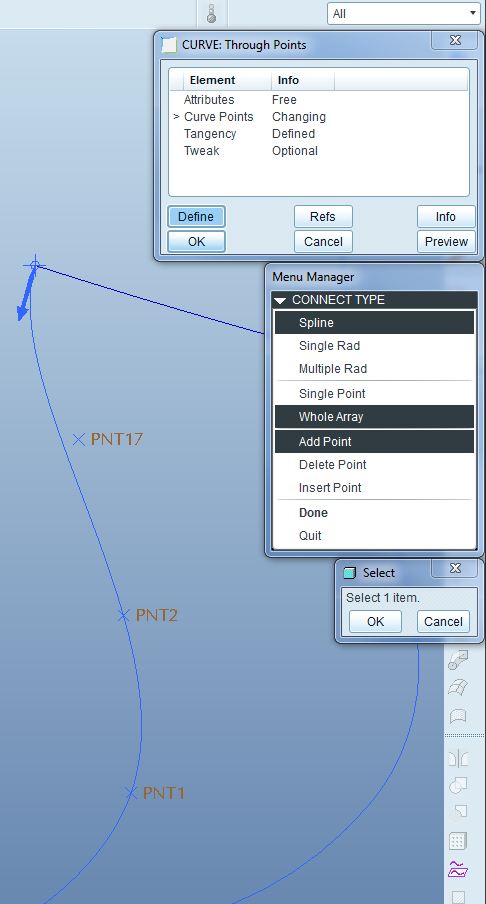

Curve through points question
Please explain the logic behind "Add Point" & "Delete Point" options. It does not work as I expect. After I think that I have deleted points and then go to add a new point, I find out that the last point I selected did not delete. The more I continue to add & delete the more confounded the curve becomes and I almost always have to delete the whole curve and recreate it.
Give me any suggestions that will save me from having to delete the whole curve in order to put new points in.
example: PNT17 needs to be added to the curve.

    Instead of trying to "add" the point - try the "Insert" option.
    Select the point to Insert before (single point) PNT2 and then select the point to insert PNT17

    Thank you PTC bird , this worked. "Insert" makes perfect sense because this is essentially what I was trying to do.
    I tried insert before, but I was not correctly reading the message from Pro/E, the part about select the point that you want to insert before and then select the point to be inserted.
    For anyone else that was confused by this, use add and delete to make the curve longer, shorter, or to have fewer points.

    Be aware that sometimes/most times the spline created thru the points creates a "wavy" curve. I've had better luck most times using a curve created via 2 sketches or a curve wrapped or projected onto a surface, or a curve created via the intersection of 2 surfaces.
