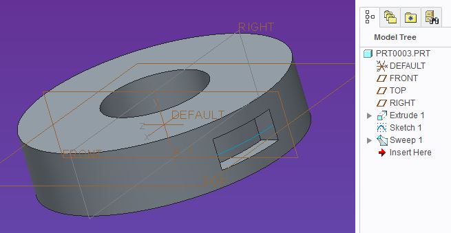

Hi guys
I havnt used creo for a while and i need to model a washer with a curved slot on the od to a depth. The washer is 50dia 12mm thk. The slot is 6wide 4deep and rotates 30 degrees. Thanks mick

    Model the washer, then add datum planes for the slot thickness (6mm) and sketch it, extrude with material removal.

    Are you looking to do something like this.  The washer is centered on the top plane.  The sketch is on the top plane with 30 degrees of the edge projected.  The sweep is 6 mm X 4 mm.
