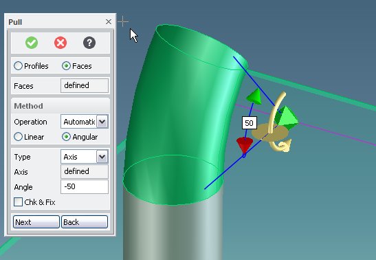

How do I go about ceating a 90 degree bend in a cylinder?

    if you like to "add" a torus on top of your exisiting cylinder you can select the face and use "Pull angular" - you might need to define the axis first (workplane or exisitng part).
    hope that addresses your needs
