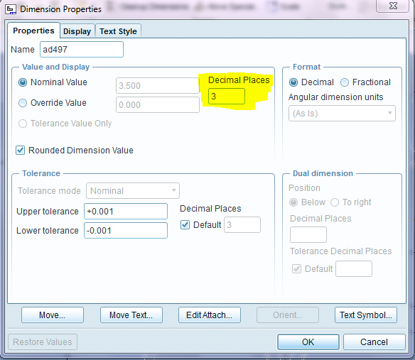

Nov 27, 2013 6:22 AM UTC
Mark all dimensions. Then:
Layout -> Format -> Decimal Place
You can also use the Searchbar top right.

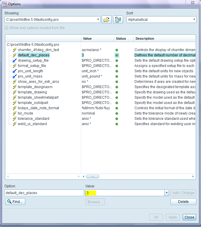

Nov 27, 2013 6:49 AM UTC
default_dec_places
value (default = 2 for non-angular dimensions)
sets the default number of decimal places (0-14) to be displayed in all model modes for non-angular dimensions. it does not affect the displayed number of digits of dimensions as modified using numdigits. the number of decimal places of dimensions created in sketcher is controlled by the option sketcher_dec_places.

We can modify decimal places at one shot by using manual method.
selecting all dimensions--->
Right Click---->
Properties---->
Change Decimal places---->
OK

Nov 28, 2013 6:11 AM UTC
Nope, it is set in the model configurations.
I set mine to 4 in the model and when I create a drafting dimension, it is 4 decimal placed by default.
I have this in my config.pro
default_dec_places 4

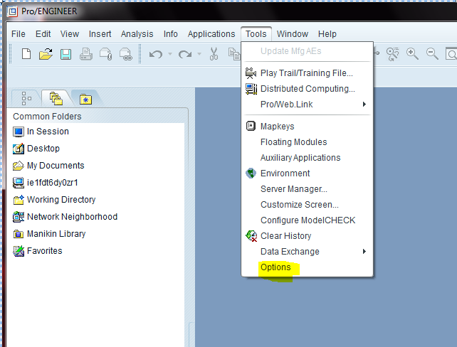

Nov 28, 2013 6:44 AM UTC
Tools--->
Options--->
default_dec_places--->
OK
