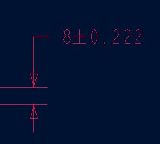

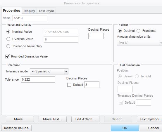

    Set the decimal places as shown.
    dimension looks like this:

    This is what I was looking for, but is there a way to put this in config.pro so when don't have to do it manually?
    Sep 9, 2015 6:07 PM UTC
    I don't see a way to set the configs for the tolerance decimal places to be different than the part decimal places.
    configuration setting is:   default_dec_places
