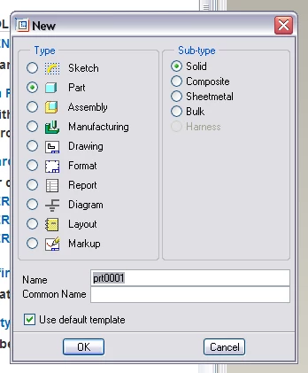

Is there a way to uncheck 'Use default template'? This used to not be
on, and I'm not sure what I did to turn it on, but I can't find what I
need to change to turn it back off. Anyone?

    Config.pro option force_new_file_options_dialog yes will gray out the check mark box
