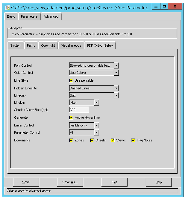

    Anyone knows whether it is possible to add a .pnt file line that allows to show the lines with the color they have in the Parametric .drw? when I publish a drawing with pen tables in pdf it shows up all in black and white. Beyond color for the lines of the views and notes (that can be set according to the line type), how could I tell the software to print the company logo in its actual color it has on the .drw?
    thanks
    bye
    Nov 6, 2015 4:23 PM UTC
    first I would check to see if the default output for the pdf generation is set to black and white
    ron
    Nov 6, 2015 4:34 PM UTC
    Hi Ron,
    thanks for your reply. How do I check this? I don't find it in any option line in the recipe editor, nor in the detail options nor in the config.pro...here is a screenshot of my recipe for you to see:
    bye
