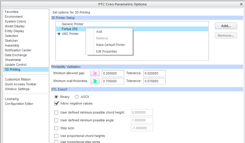

Delete a place holder 3D Printer
How do I delete this place holder 3D printer. The "Remove" option is grayed out.

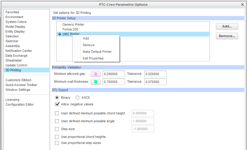

Feb 11, 2016 3:42 PM UTC
Corey,
As a test can you Add a new printer, give it a random name, leave the default values and then after it's added, see if Remove is available.
Amit

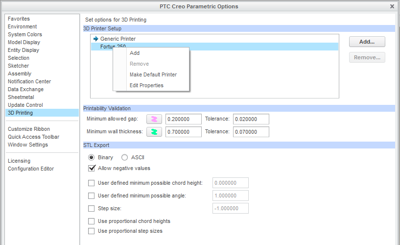

Feb 11, 2016 4:08 PM UTC
I can add or remove more printers, but the original is still grayed out and does not let me remove.
Feb 11, 2016 4:10 PM UTC
I tried alternating the default and removing the original "Fortus 250" with no luck as well.
