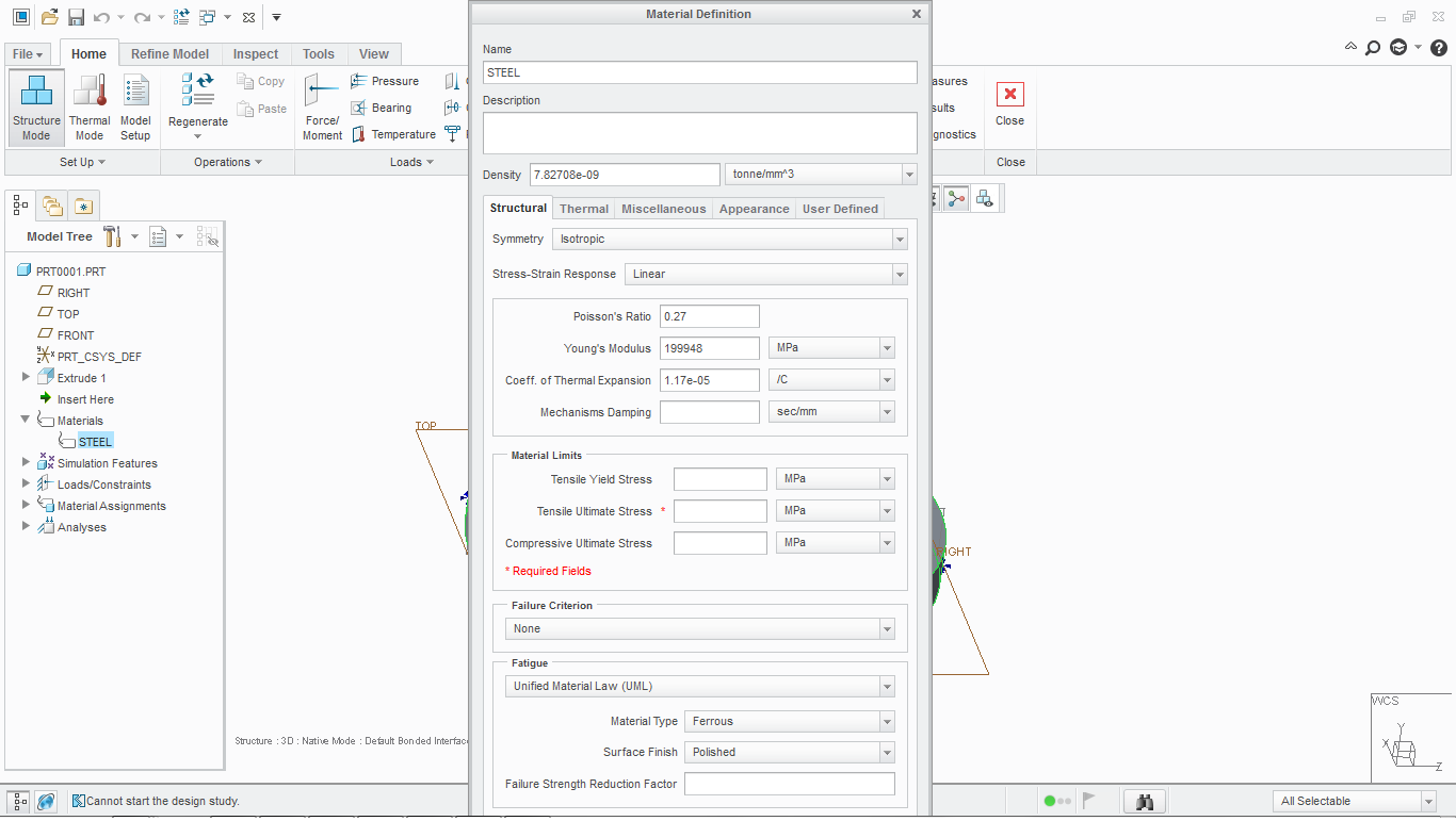

Hello all,
I dont know if anyone else has faced this problem. Some dialogue boxes just dont fit in the screen. So I am not able to click the OK button to save the changes. I tried a lot to resize the box but couldnt do so. Any help would be aprreciated. (pls see the attached screenshot)

    Shashi...can you increase the resolution of your screen?

    Hello Neal Hanratty,
    No I cant as it is already set maximum 1366*768.

    probably your screen resolution is too low. I think the requested minimum is 1280x1024.

    Hi Martin,
    (Thank you for your reply)
    OH OK!! but max screen resolution for my laptop(15.6in display) is 1366 x 768 . Any alternate way of sorting out this problem??

    Shashi
    The only answer I would have is to connect your laptop to a stand-a-lone monitor to see if you can run at a higher resolution on it.
    Also I have noticed on some PCs that if you drag your mouse towards the bottom of the dialog box it will 'move itself upwards' to allow you to see the previously hidden section.
