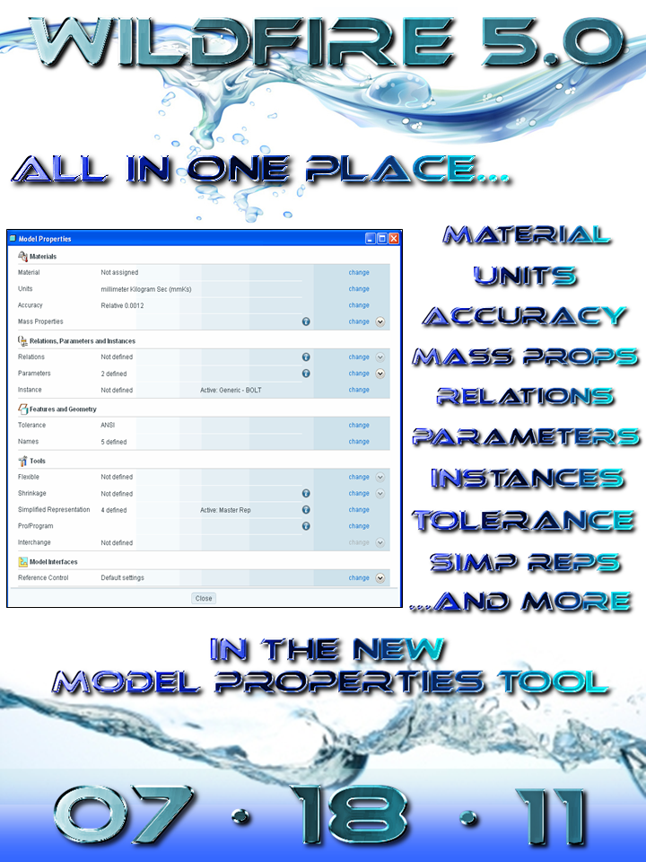

    Hi Shankar...
    I compiled a nice list of enhancements we used to "advertise" the new Wildfire 5.0 release to our users. We posted these as fliers in the hopes of building some excitement for the transition from Wildfire 3 to Wildfire 5.
    Click on the images below for a better view... I figure no one from my company will mind if I post these.
    There were more posters but these are the ones that highlighted feature enhancements in WF5.
    Thanks!
    -Brian
