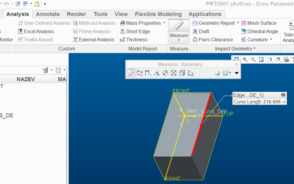

i 'm beginner.. facing a problem regarding dimensions.. they initially appear as

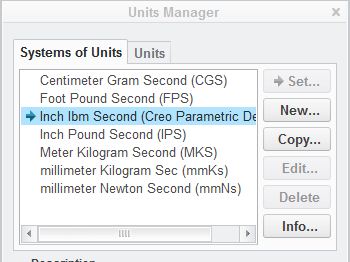

SN1.JPG perhaps these are in mm. i want to use inches, i went here SN3.JPG they are already in inches.. i changed to others settled them back to this but no avail.. they keep appearing the same way.. i want to work with inches in single digits but when i type in 1,2 thing appear in micro..nd i guess they show 1mm,2mm etc not inches...while by default creo is set to inches.. i 've creo 3.0 M020 educational edition

measure edge of your model to see lenght units.

i got that..but what should i do so as to work with smaller values, the lines,arcs etc appear too small.. If i zoom in while working 1st it does not present an appropriate interface plus when i complete an operation nd hit the check mark it switches to normal nd things appear too small.. in short how can i change relation b/w on screen length and actual length?

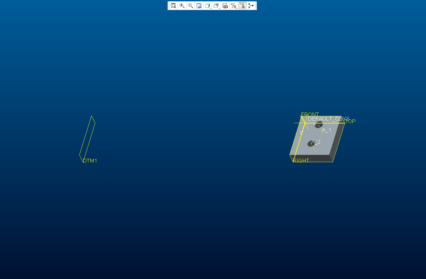

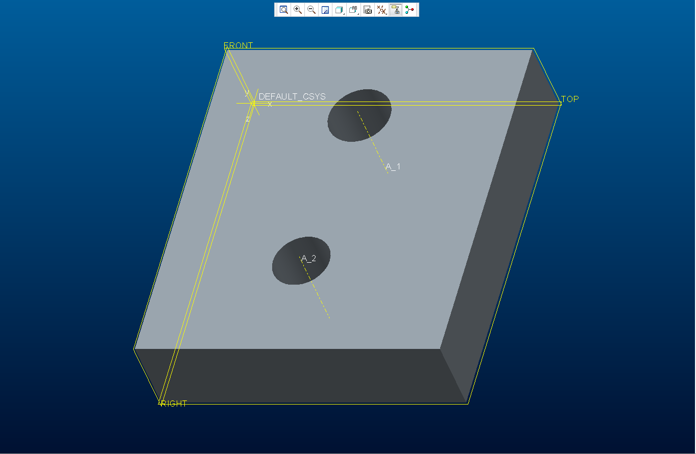

Aug 7, 2015 5:07 AM UTC
Ahmad,
please, next time upload some explaining pictures.
Default display is affected my datum geometry display.
Model without offset datum plane
Model with offset datum plane
