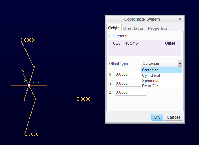

    If you really want to be wild with orientations, and you can manage them, ...using coordinate systems will help set up groups of features. You still need planer and axial references, but they can all be tied to a more independent CSYS from the default. If you know how to specify and manage the CSYS features, you have great control over feature group relations.
    Arod, please clarify "true 3D space"? It is true that Creo has a predefined "origin", but that is more for it's own reference. I always start with empty parts and the first feature I place is the CSYS... the default coordinate system. The second click is planes to get the 3 default planes quickly. Now I have a 3D reference for everything else. If I want 0,0,0 to be a reference to somewhere else, I just create a second CSYS in relation to the 1st and never bother the original again (avoid references to it).
