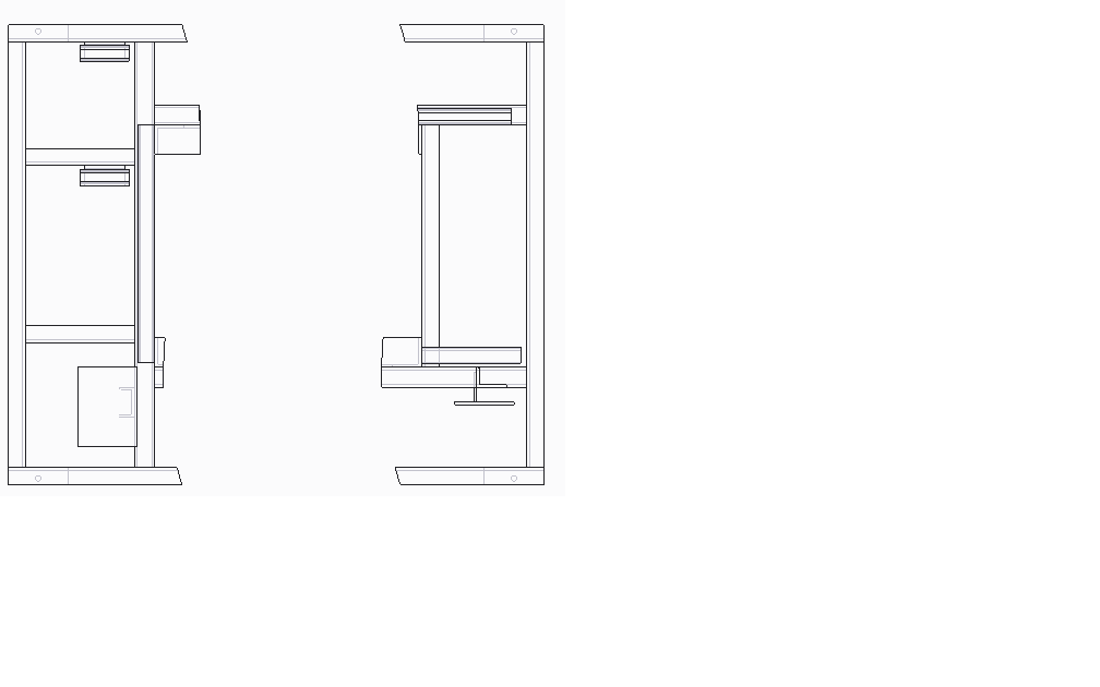

Display the FULL Break boundary lines (s-shape/heart-shape) in a broken view
I have opened this case for a technical support from PTC. The following was responsed by a technician:
"As I informed you that, this functionality is currently not available in Creo parametric or Pro/ENGINEER Wildfire; however you can file an enhancement request for that. Use this link to file a request."
Does someone know how to display the FULL break boundary linese in a broken view?
Parameter/setting that can display the FULL Break boundary lines (s-shape/heart-shape) in a broken view

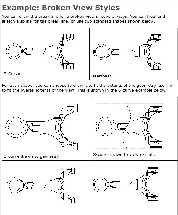

    This is what you can do with broken views:
    ...from the help files under "broken view"
    cliu1-VisitorAuthor
    Jan 22, 2013 8:41 PM UTC
    Thanks, Antonius Dirriwachter.
    Unfortunately my question is for to show the FULL break line for a frame like this. There are only BREAK LINES over the parts having "material", no BREAK boundary at all over the part no "material".
    Jan 22, 2013 9:01 PM UTC
    Doesn't the 4th option give you that? S-curve drawn to view extents
