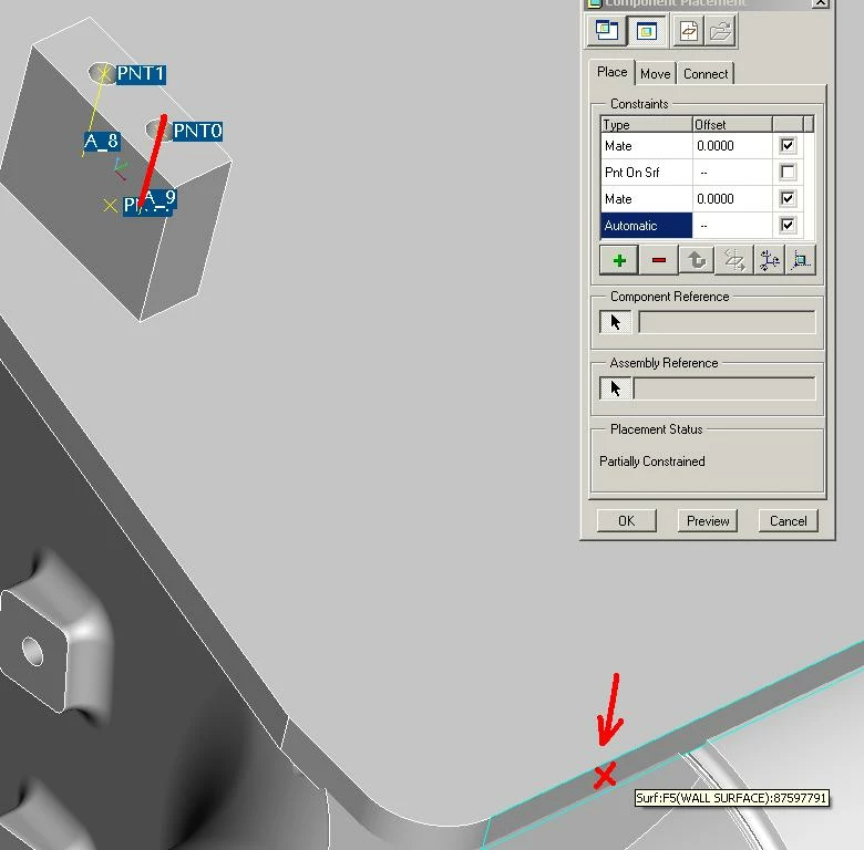

Can I put distance between a axes and some plane (similar Autodesk Inventor)?? or I have to create planes and align them ??
    Jan 10, 2008 3:59 PM UTC
    Actually I need in Component Placement add constraints between some part_axis, "A_9" and some plane of my assembly, "F5 (WALL SURFACE)".
    I can do this using a datum point, or creating planes, but I guess it's expend many time to do.

    No, unfortunately you cannot constrain an axis to a plane. It would be
    nice, but it isn't possible now. You'll need to create some other
    geometry.
