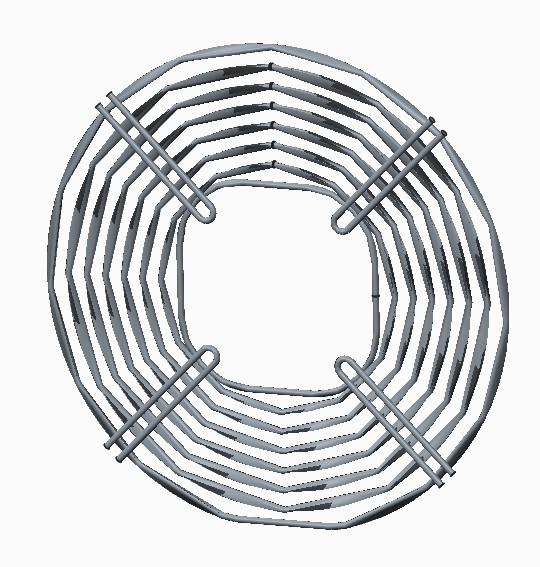

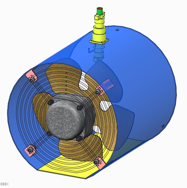

Hello, everyone!
I wonder why Cre misrepresents a model of a fan guard in a shaded with edges mode.

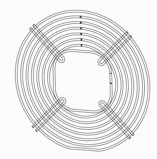

The only way to see it correctly without any distortions is to switch from the shaded with edges mode to the wireframe mode.
In the other modes Creo exchanges circles for polygons.
Thank you in advance.
Best regards, Vladimir.

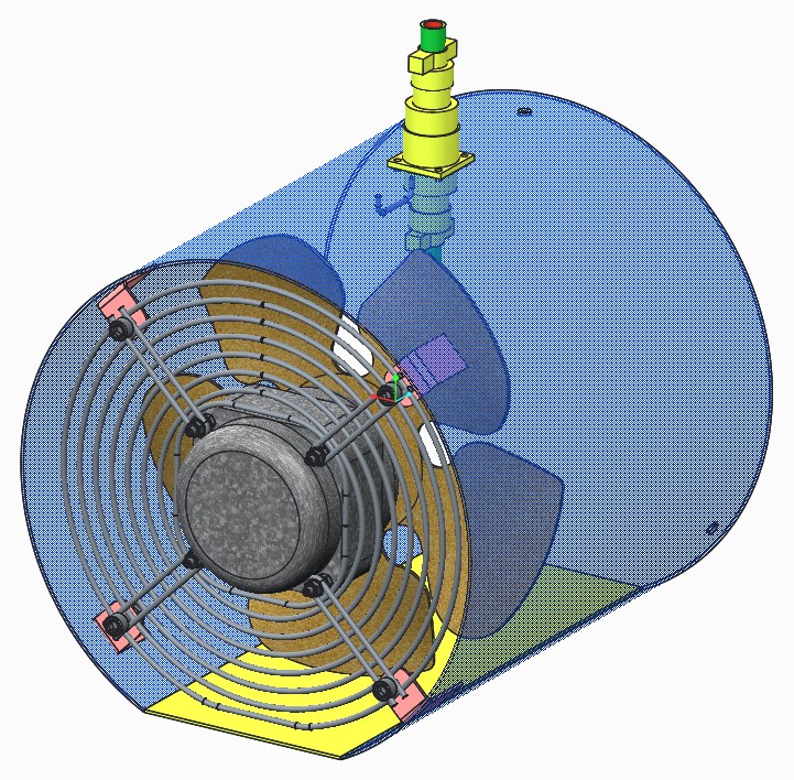

    Apr 24, 2012 5:10 PM UTC
    file --> option --> model display --> set shade quality to: "10"
    file --> option --> entity display --> edge quality display "Very High"

    Apr 25, 2012 4:45 AM UTC
    Thank you very much for your help, Aries.
    That works.
