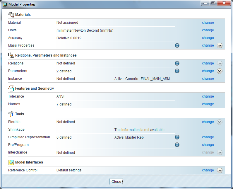

In Pro/e wildfire 5.0 version, Edit-setup tab is missing which contains the different menumanager options.These options are available in Pro/e 4.0 and earlier versions. Where are these tabs placed in the current version 5.0?

    Hello
    New enhancement in Creo Elements/Pro 5.0 (formerly Pro/ENGINEER Wildfire 5.0) is new Properties configuration window (File > Properties) where you can find all commands from old tab.
