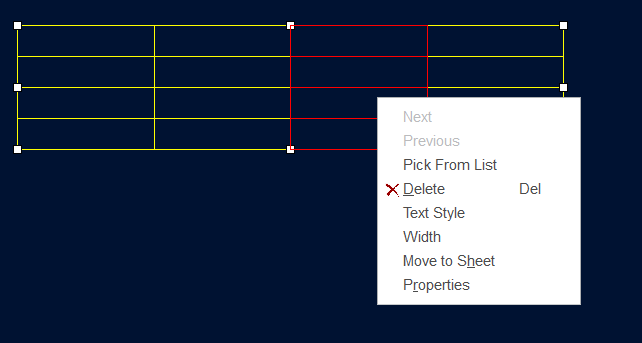

Is there a way to remove rows/columns from tables? I see how to add, but not remove.

    Ok, Select table row/column > RMB > DeleteTable.png

    Are you referring a repeat region table or standard table?
    If it is a repeat region you cannot remove row, however you hide the row in repeat region using filters.

    standard table

    Using "query-select" instead of the (lame) pre-highlighting allows you to easily scroll thru options like cell, row, or column. It also allows MUCH better selection of references to prevent bad parent-child relationships.
