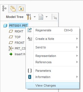

can anyone let me how to enable the model tree seperate dialog box creo 2.0 ,earlier i use to get this ,now it is disabled.
it  willbe in view-->show-->model tree

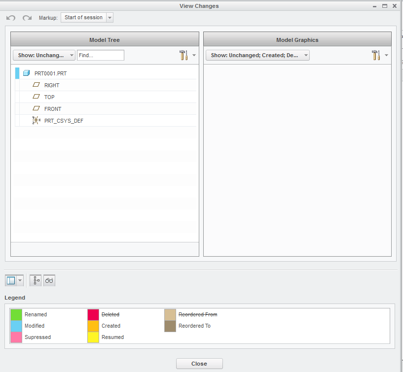

    There is a way, but it will close as soon as you make a new feature. Right click the part and click View Changes, and undock Model Tree appears.

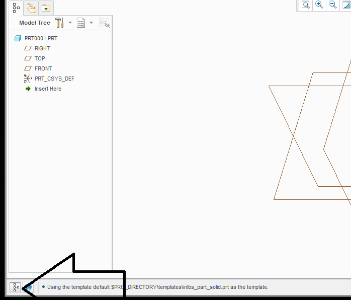

    I misunderstood your question, use this button then.
