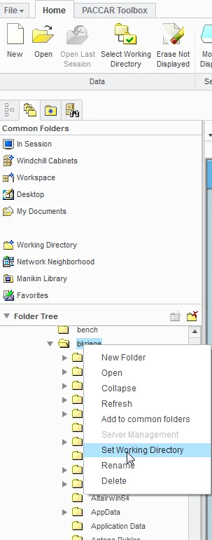

    Yes, the Common Folders tab is very useful for those in PDMLink, etc.
    FWIW, you can rmb and set working directory from the folder tree list:
    [cid:image001.png@01D003EA.754151B0]

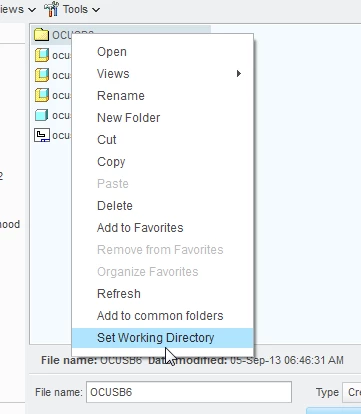

    Or from the file>Open dialog box.
    [cid:image002.png@01D003EA.754151B0]
    Not sure if that’s what you meant by current folder or not, but hey, it beats a sharp stick in the eye.

    November 19, 2014
    You do have the option of adding your own folders to the Common Folders:
    [cid:image003.jpg@01D003ED.50CDEE30]
    It’s handy for any library folders that you have, to make access to them easy.
    I agree, it would be nice to use the common folders to set the working directory.

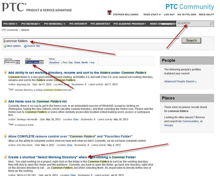

    dgallup1-VisitorAuthor
    November 20, 2014
    Thanks to all for the links, my brain did not associate Product Ideas with software ehancements.
    That Product Ideas page is a diaster, there is no way to search through them, only sort them by meaningless terms like "most popular" or filter by equally meaningless terms like "Under consideration". There is a search box at the top of the page but it searches all of PTC communities so is useless.
    When I started to create a new "Product Idea", the site actually did an active search as I typed my title and I found an old submission that is eactly what I wanted to ask for. So I voted for that one but now I can't find it again! So PTC CAN search & sort this stuff but won't give us the tools to do it.

    StephenW
    November 20, 2014
    The idea you voted on is
    StephenW
    November 20, 2014
    Oh and easier to add an image…
    [cid:image001.jpg@01D004A1.22893ED0]
    November 20, 2014
    I never got to the results page because it puts up a display of the matching content as soon as you start typing in the search box. When I say all the garbage it was returning I gave up hope. Maybe if I spend a more time there I’ll eventually learn to like it.
