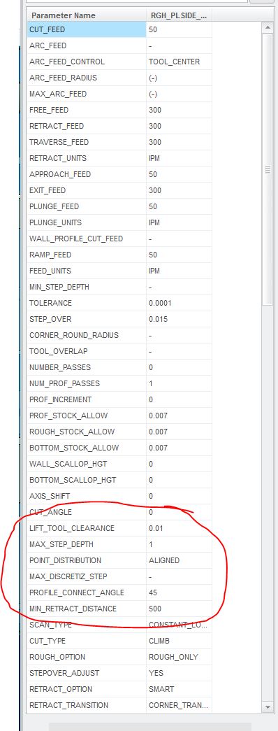

    I am still using the old classic volume sequence for most of my volume style sequences since the parameter addition of Min_retract_distance and Lift_tool_clearance with the constant load it give a nice semi trochoidal tool path with out much effort. I helix into the bottom of a pocket and let it go Nice path and reasonably quick.

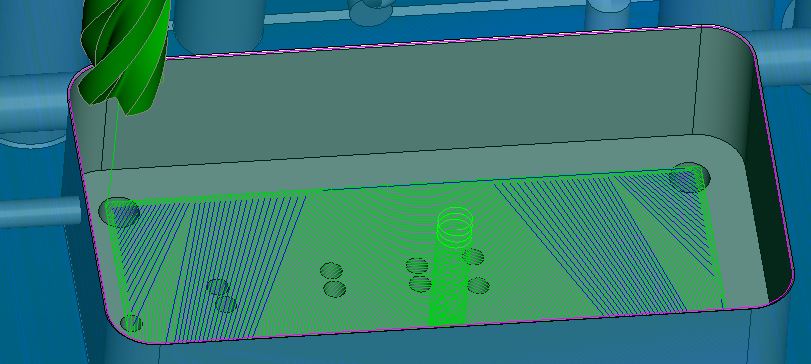

    Bill, I started this answer Friday and got interrupted. I have been doing 3 sequences to get around what you are talking about. The first sequence as above to rough the pocket. I then do a bottom sequence with the parameters set to spiral and rough only and a helix entry with wall stock on so the cutter doesn't hit the side walls. If you try and finish the pocket with the parameters to spiral and faces_only it seems to try and be efficient and avoid any holes in the pocket which I suppose is good if you have a large pocket with not many holes but it's crazy when you have a 2" X 3" pocket with 10 holes all over the place.and the faces_only parameter will only helix in on the first cut then retracts and just plunges after it encounters one of the holes or another region to mill.
    then I finish the walls in the third sequence with the parameters set to follow_hard_walls and profile_only with a lead in and lead out to set cutter comp. Unless there is a void or gap in the wall  then it has to retract and jump over the void. so the I do a mill volume or trajectory so I can get a continuous wall cut.
