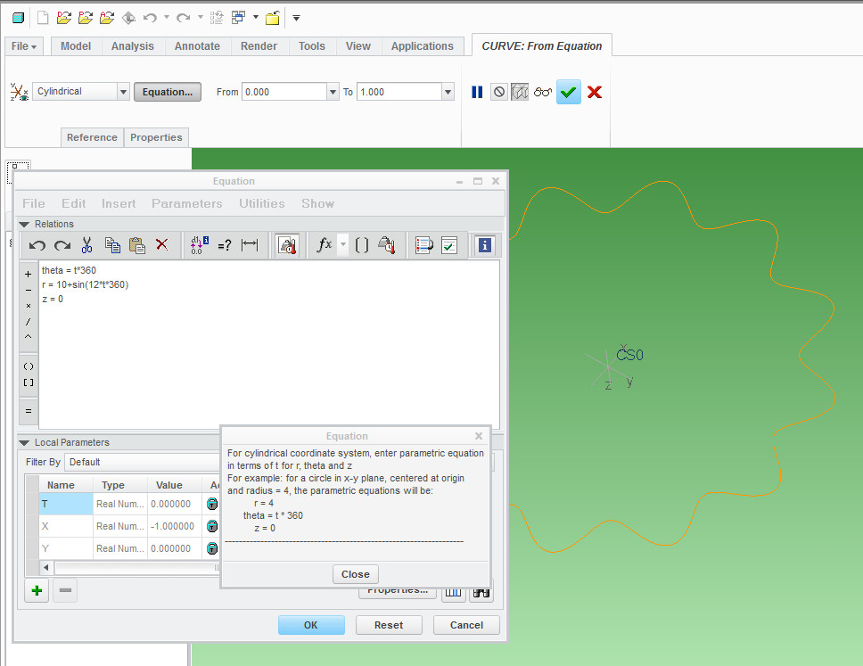

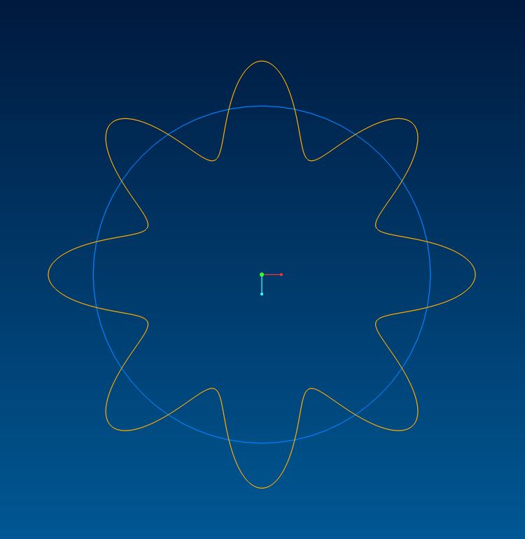

Hi all, is it possible to define the curve shape shown in the attached image by equation only? I know this can be done using surfaces & trapar, then just coping the resultant edge, but i was just trying to simplify my approach. (its the star shape i am after).
Regards
John

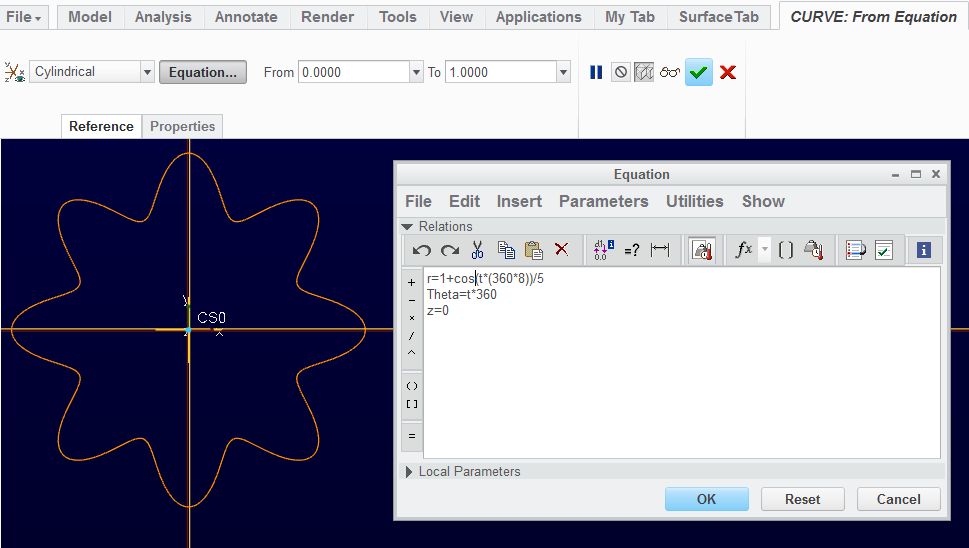

    yep, pretty straight forward...
    the key element is R
    Cos() and Sin() work similarly; it tells it how to start. Each has a value range of -1 to 1. Sin starts at and ends at 0, cos starts at 1and ends at 1.
    (360*8) is the number of cycles (360 is one full cycle)
    To keep the equation "positive", the initial radius is set to 1
    Theta just says to rotate once (360 degrees) by saying "t*360" it specifies a range from 0 to 360.
    Z... well Z is Z. You can operate on Z is you want somethign like a helix.
    Notice that the "type" of equation is cylindrical. Remember to pick a CSYS.
    Aug 27, 2014 8:13 PM UTC
    ... T is essentially trajpar. Trajpar is always 0 to 1... where in the equation, you can extend the range of T.
