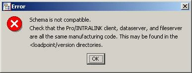

error
Can anyone tell me what this means & what we're to be looking for to find
the code? This has only happened with one user, all others are ok.

    Lyle
    This can happen if there are other oracle programs installed. We
    sometimes get an issue if the smarteam (oracle ) based is used before
    intralink is started.
