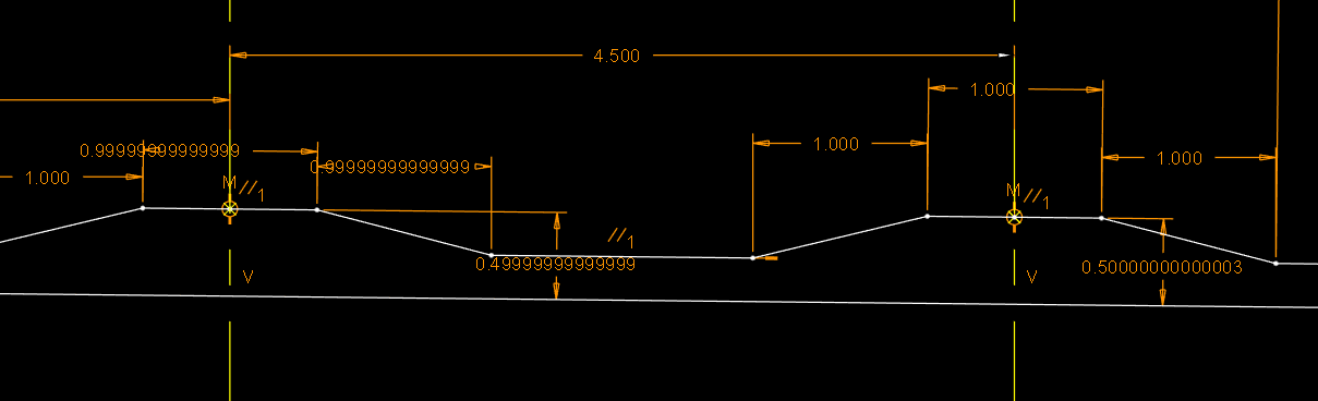

Anyone know why sketcher is displaying so many decimals on dimensions that I make strong? My company recently switched to Creo 2 and I never used to have this problem. I didn't define these values with this many decimals...Creo did this automatically for me.

    Set those dimensions to "round" value to 3-place decimal. RMB menu.

    Is this a part made in an older version?

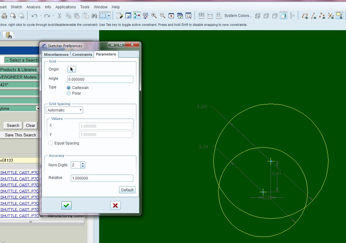

    while in sketcher mode , go to sketch,options, parameters ,set accuracy /num digits sketch.JPGto 3,green tick

    Setting the accuracy sometimes will not change these few dimensions, that's just a general setting.
