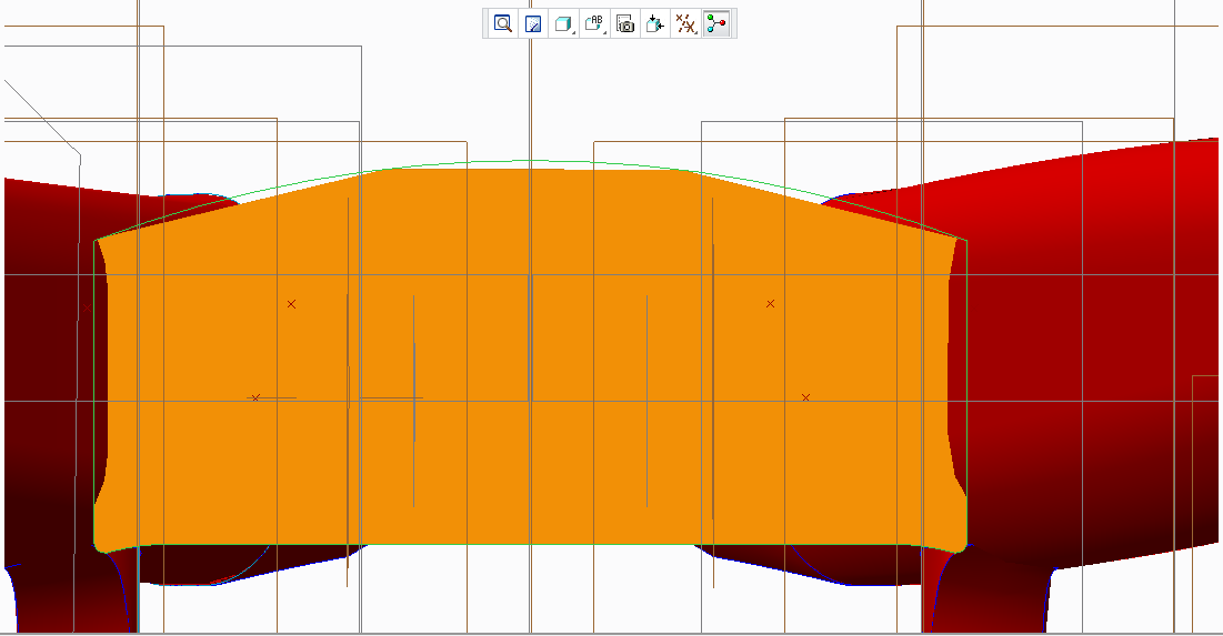

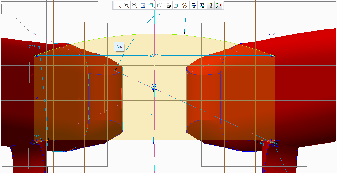

I tried to extrude this arc, what happens is that it becomes in a really poor arc with no smoothness at all.
What should I do?
Thanks!

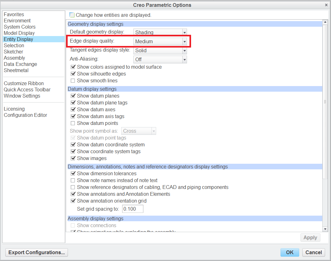

    click File > Options (if you use Creo Parametric 2.0) and experiment with below show settings.
    Martin Hanak

    I think you should change the accuracy in the "model properties"

    Alex, how should I do that? I changed but nothing happens, the arc remains with the same imperfection.

    Ruben,
    Martin Hanak
    Sep 9, 2015 1:51 PM UTC
    Martin, I set the edge display quality to very high, even with that the arc is still appearing with little "pixels", I render it with maximum accuracy and that doesn't solve my problem.  I know that this is the correct procedure and probably the correct answer, I'm just wondering if there is another procedure to solve this.  Thanks!

    you can also test adding the following option at the end of config.pro file temporarily. This way you will turn OPENGL graphics off.
    graphics win32_gdi

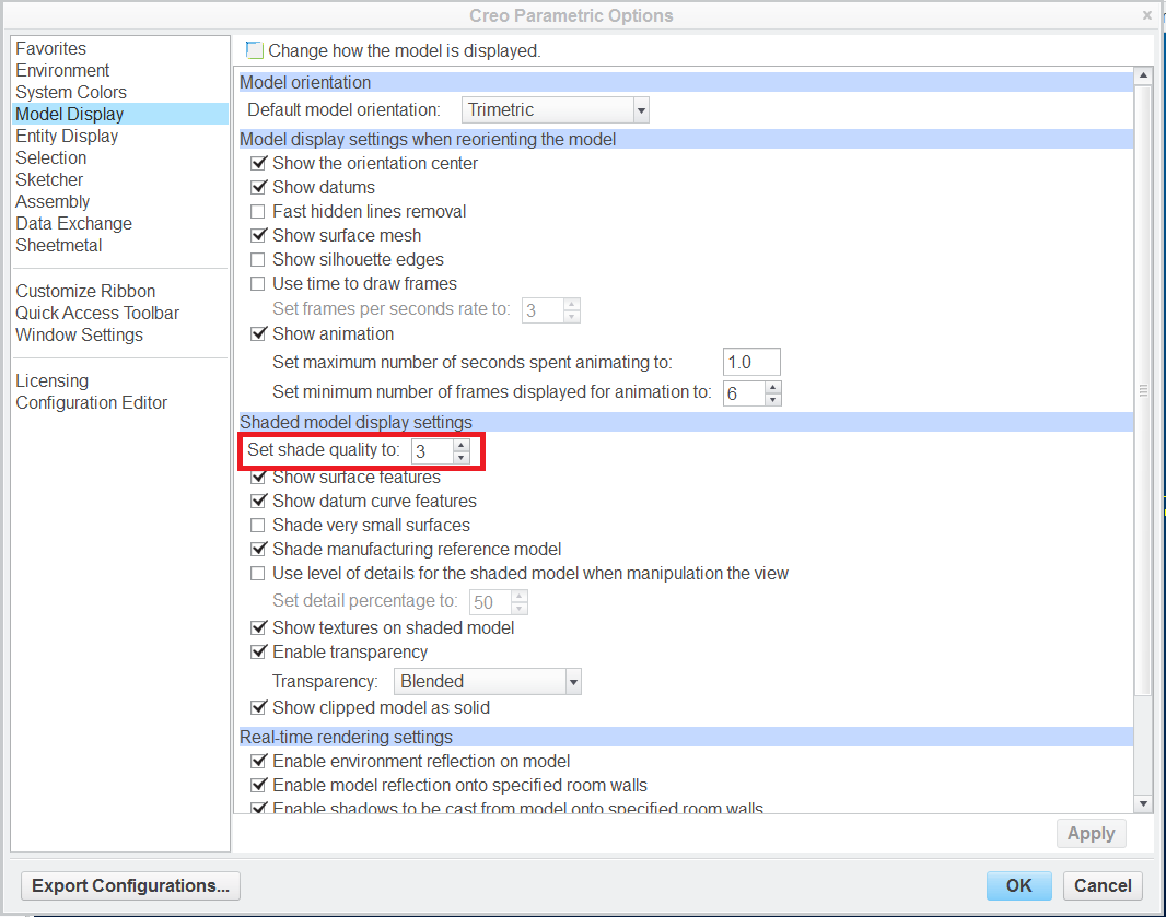

    You only mention that you set your edge display to "very high"
    Try setting your shade quality to "10" too.
    ron

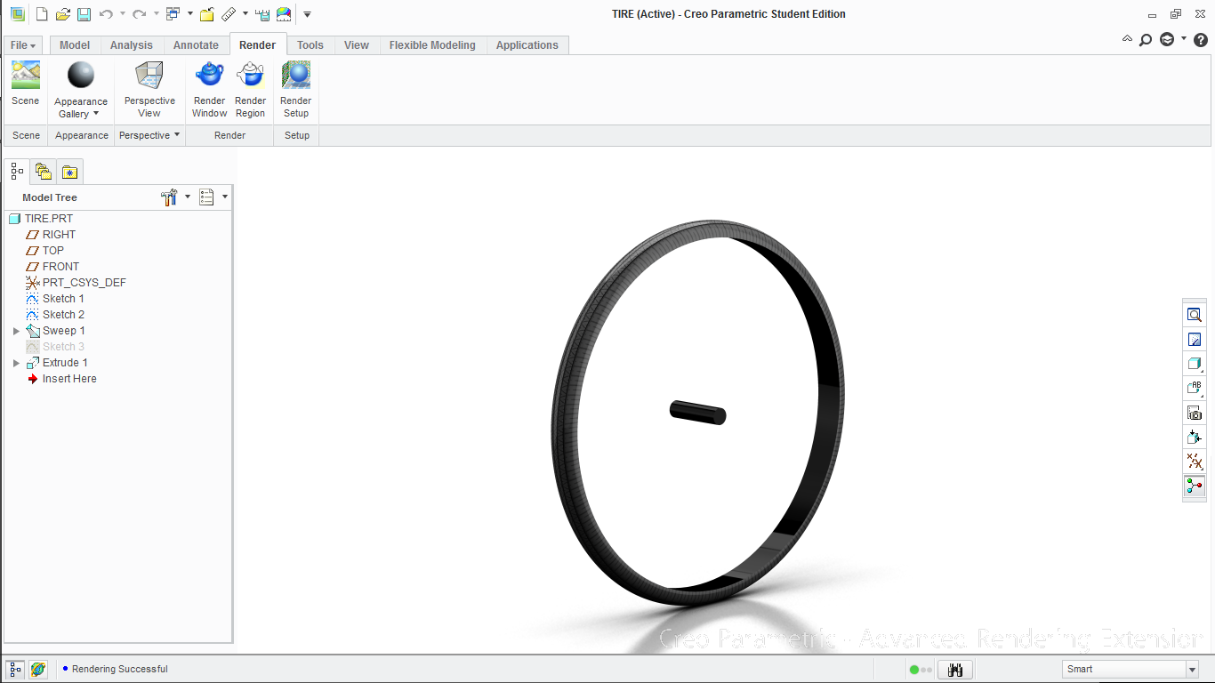

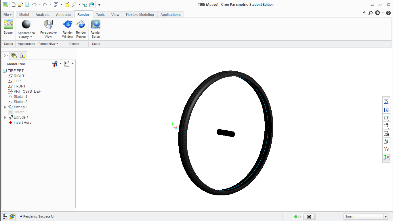

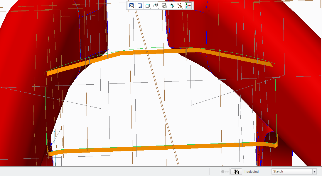

    Sep 12, 2015 9:55 AM UTC
    I didn't understand how to add the config.pro file that Martin said. So, this was the result with the edge display set to very_high and the shade display quality set to 50 (highest value possible).
