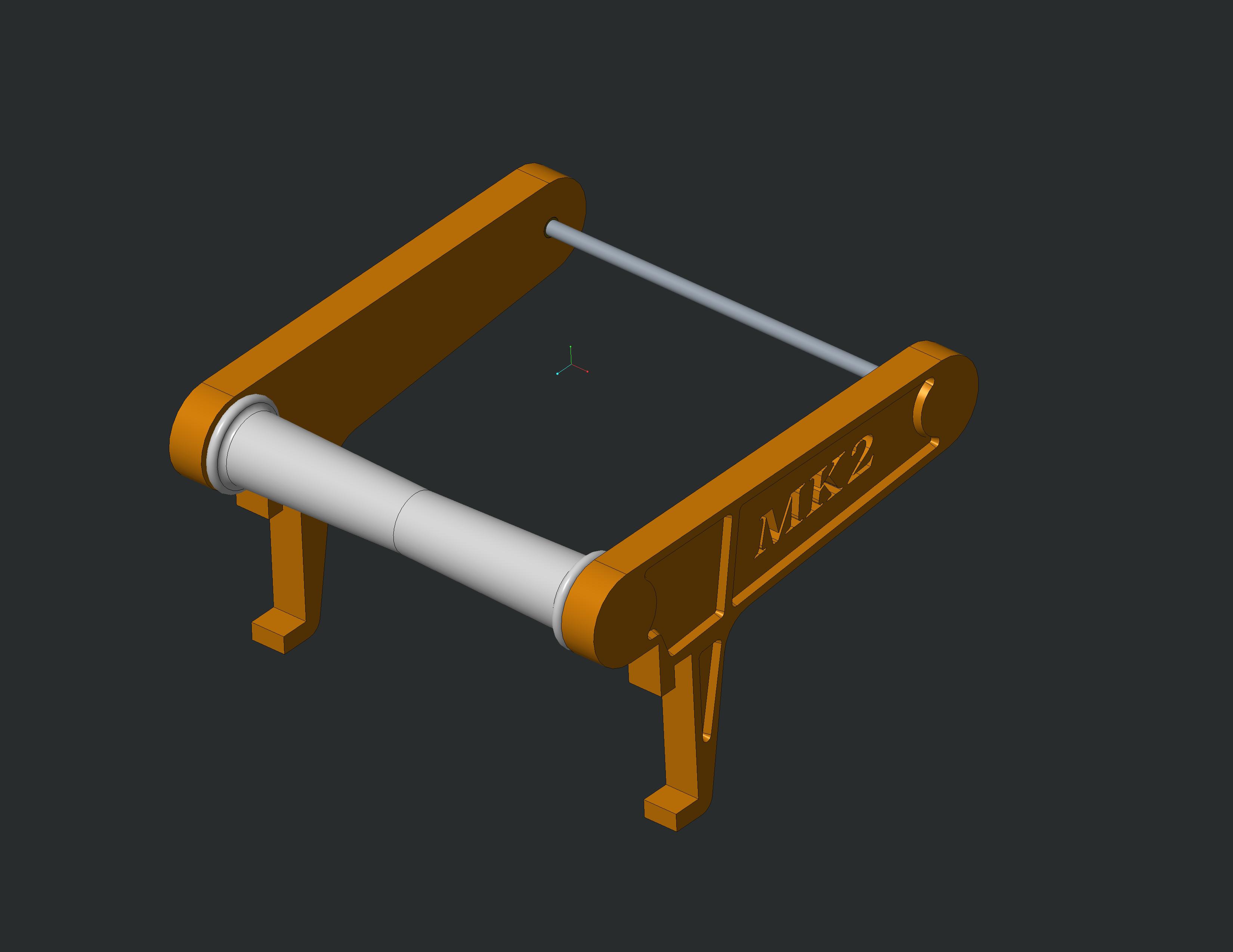

I am using Creo 3.0 as you can see by the attached picture below there is some text (MK2) on the right support bracket. I then saved a mirrored copy for the left bracket however, the text is not correct as I need the text to read right-to-left opposite the original text which reads left to right.
I have tried a number of ways of mirroring the text with no luck I was wondering if anyone has another options I could try. Thx.

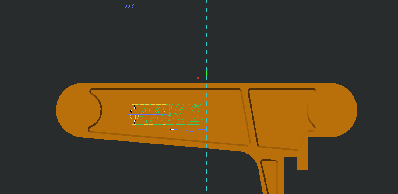

A better way of describing what I am looking for is I would like the text to read the same on both sides of the bracket.

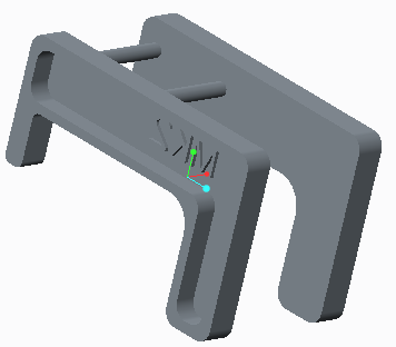

As you can see when I try to add text to the left side the text is not correct.

    If you mirror the part, the text reads backwards. Is this what you want?

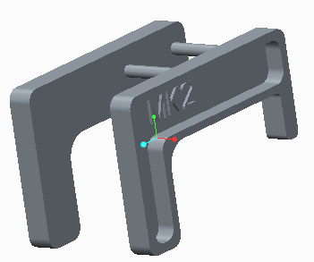

    Then you need to mirror the part BEFORE adding the text to both sides.

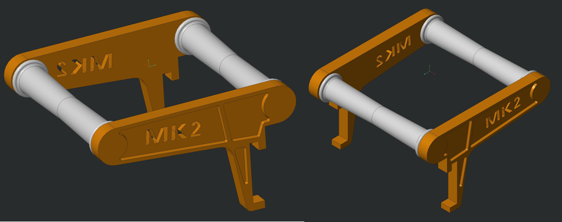

    I presume this is Sketch > Text.  In the dialog for it, there is a control called 'Aspect Ratio', where you can type a number or slide a slider to control the ratio of height to width.  Type a negative number, and the text will be mirrored.

    I entered a negative value and yes it mirrored but the letters were not correct.

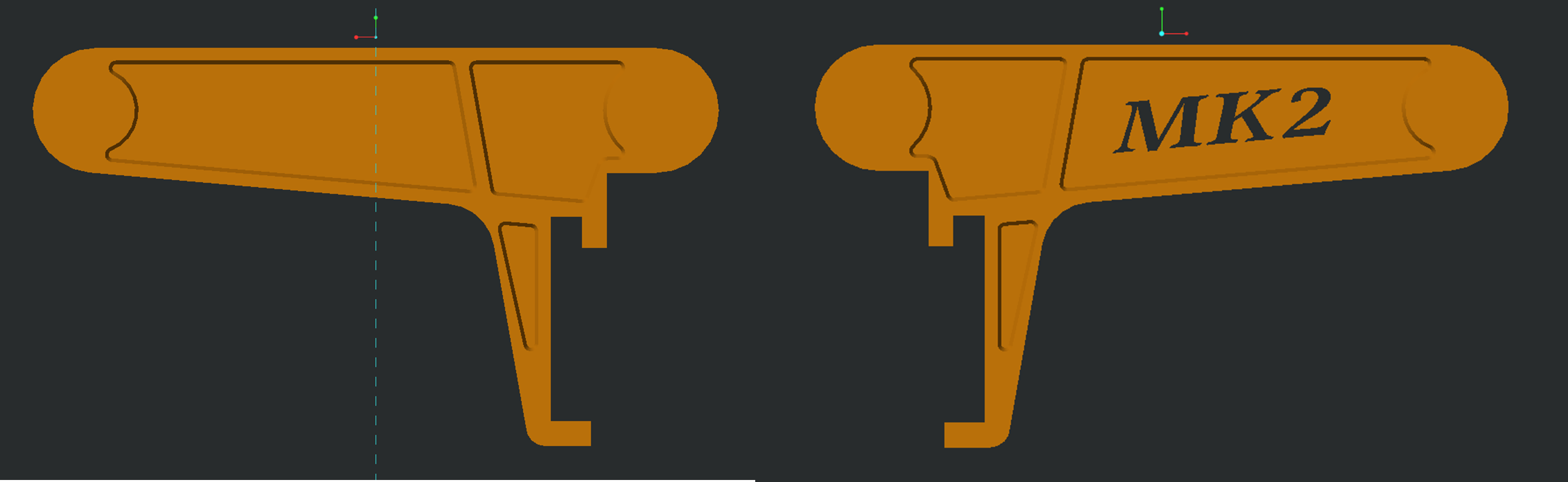

    I am trying to have the text read the same on both the brackets so if you where to look at it on the left or the right it would read the same.

    Perhaps you want the letters to be (reading from left to right, looking at the "embossed" side of the part):
      - for right bracket "MK2"
      - for the left bracket "2KM"  ?
    Please submit an image of the desired result for the left hand part.

    After many attempts I have realized what I was originally hoping for is not possible because of the ‘K’ so I am sorry for wasting your time however the design is now complete so thank you for your help it was appreciated.
