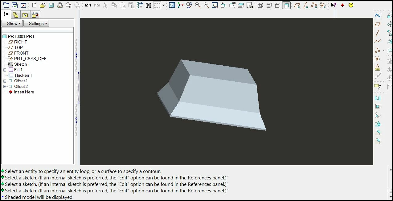

    You can use the offset with draft tool. There may be other ways, you can do a split draft with the draft tool.
    I couldn't start with a quilt though. I had to thicken it to .02 inches to get it to work.

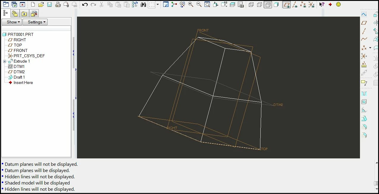

    I think it would be more practical to create multiple extrudes, and put draft on them as you go, the afore mentioned isn't the best way to do this.
    The first attachment is a split draft on an extrude using DTM2 as the hing.
