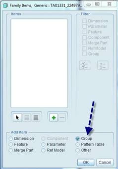

    Hi all,
    Although I have been using family tables for quite a long time, I have never used the Group option as seen in the figure below.
    [cid:image003.jpg@01CF9515.79F588A0] [cid:image004.jpg@01CF9515.79F588A0] [cid:image005.jpg@01CF9515.79F588A0]
    I would like to add multiple components to a family table and they are nicely organised in groups in the feature tree.
    I thought I might be able to reduce the amount of columns dramatically using this option but have been unable to select anything.
    I even tried creating a simple part and grouping features then selecting to group for a family table...no luck.
    There doesn't seem to be anything in the "Help Centre" and I can't remember anything about this in the training.
    Has anyone ever used this option? Does it work or is it just there for show? Or is it for some other type of group I haven't thought of?
    Any help would be appreciated.

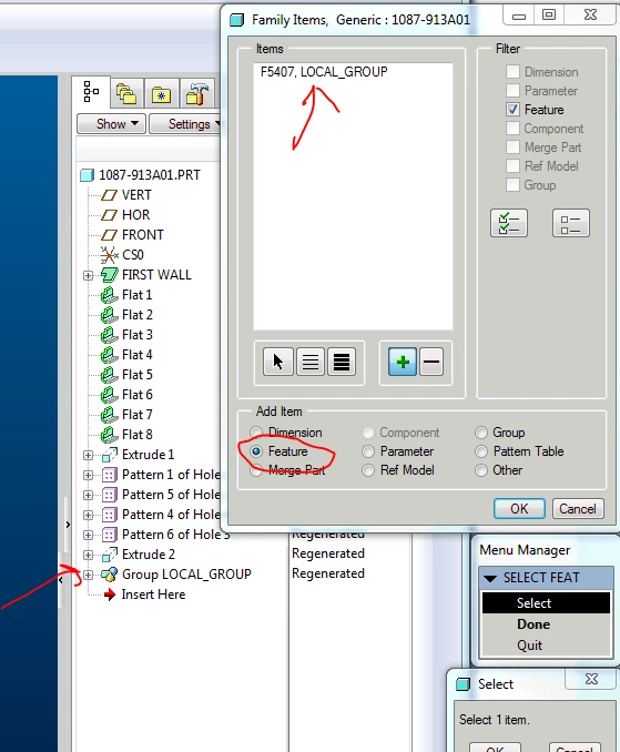

    Jul 1, 2014 9:52 AM UTC
    Craig,
    I also assumed that since there is a radiobutton that reads group you would use that to add groups.
    It works when you set/select feature (i.e. in WF4) in part or assembly mode
    [cid:image001.png@01CF9522.A4BDC2C0]
    Jul 1, 2014 8:57 PM UTC
    In parts and assemblies a Group in the model tree is a Feature, so that's how it is added to the family table. The Group in the family table selector is (I believe) for UDFs.
