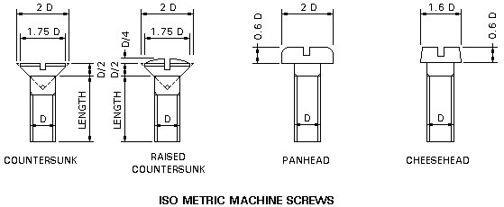

    This is image is an illustartive image.
    You need to have dimensions and normally its related with dia of the stud.
    So if you know what are all the dimensions to be applied you can calculate relating to D.
