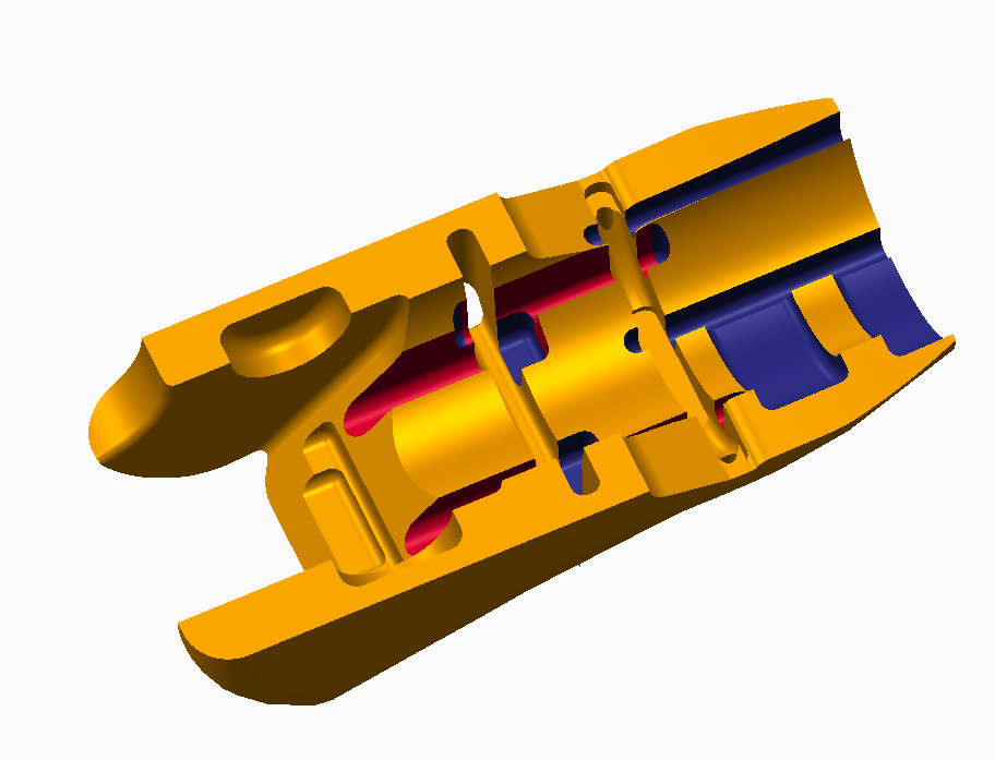

Features randomly changing color in Creo 2.0
One of the users at work just recently experienced a strange occurance with a model he has been working on over the past couple of days. He opened the model he was working on, and noticed that certain features have changed color. See below:
I've personally never seen anything like it. Any idea as to what could've caused this? We're running Creo 2.0 M070.
    Apr 22, 2014 1:11 AM UTC
    Nothing "remove all appearance changes" won't fix. I suspect it is acting on intent surfaces and it got confused.
    Apr 22, 2014 12:43 PM UTC
    Thanks, that did the trick!
