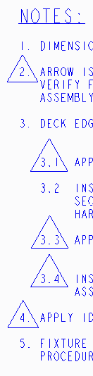

Is there syntax for having triangle flags added to text in a note?

    &sym(symbol_name)
    For example, if you symbol is flag.sym
    &sym(flag)
    Make sure the flag.sym is already "in-memory" in your custom symbols in that drawing.
    And I don't really like it because it messes up the text font spacing...personal pet peeve of trying to line up notes on a drawing.

    Good deal! Thanks Stephen! I see what you mean about spacing. Will toy with. Wayne
    Mar 31, 2017 6:15 PM UTC
    You can get the horizontal spacing correct by making adjustments to how you draw the symbol but I think you'll always have a vertical offset between lines unless the symbol matches the text height.
