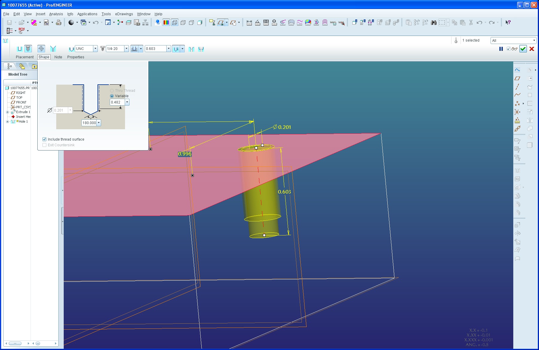

Has any body figured out how to make the bottm otf a tappeed hole flat?

    Michael,
    On WF5.0 I am able to enter 180° as the angle for the drill tip and that show up as a flat bottomed hole. You would think that there should be a checkbox for flat bottomed or not, but this seems to show the geometry the way you want to see it.
    -Greg

    Works for me Thanks
