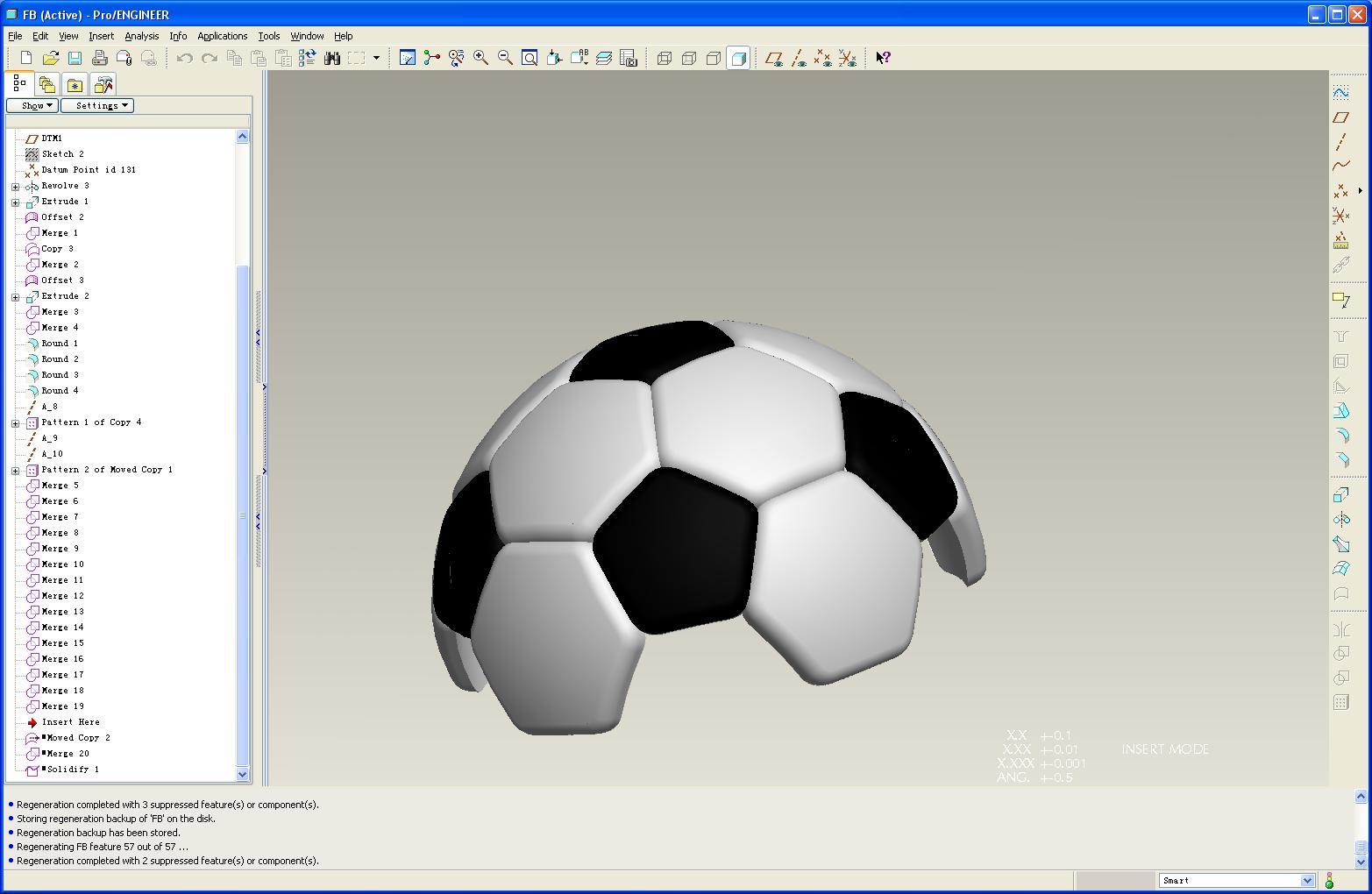

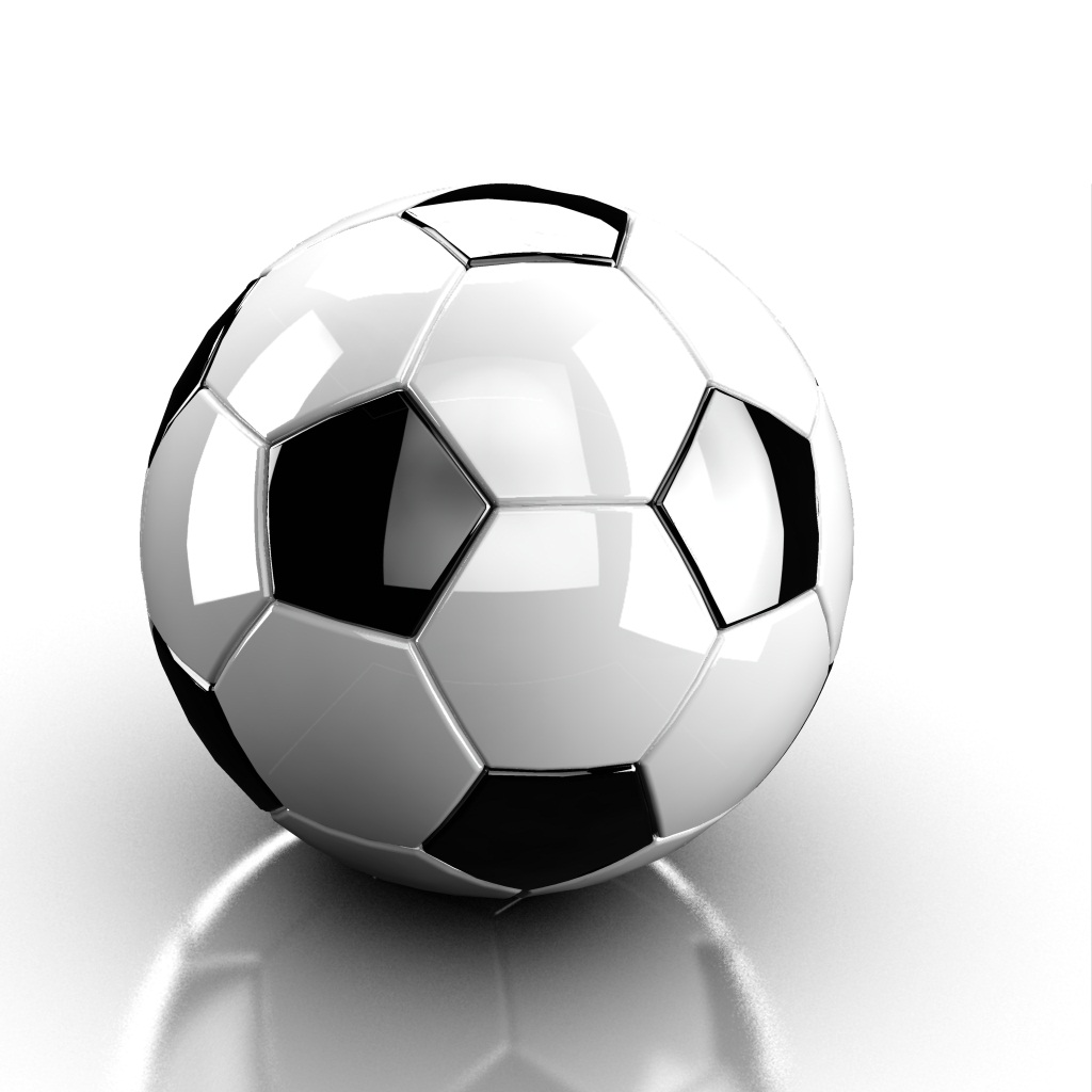

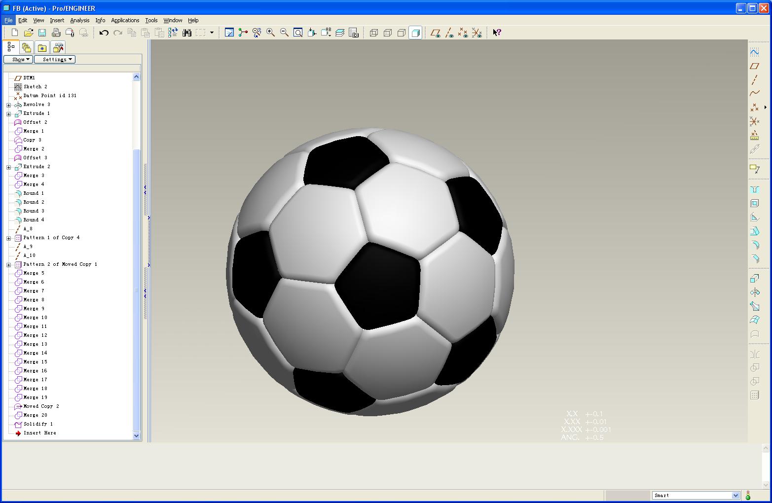

    Here are a couple of soccer ball modeling approaches for you. The first is a flat-faced single part model created with Fill surfaces. One could also create such a truncated icosahedron by cutting a solid. Many ways to approach this. The second model is an assembly of pieces. They are actually shelled out to simulate the sewn patches of a real ball. (Could add holes for the threads I suppose, but that really would be gilding the lily.)
    In both cases the modeling was facilitated greatly with patterns around one principle axis.
    David
    Jun 27, 2010 1:22 PM UTC
    Just a little more on the assembly. All done with CSYS constraint; piece of cake.

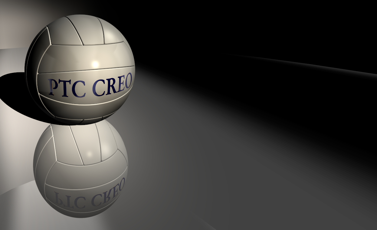

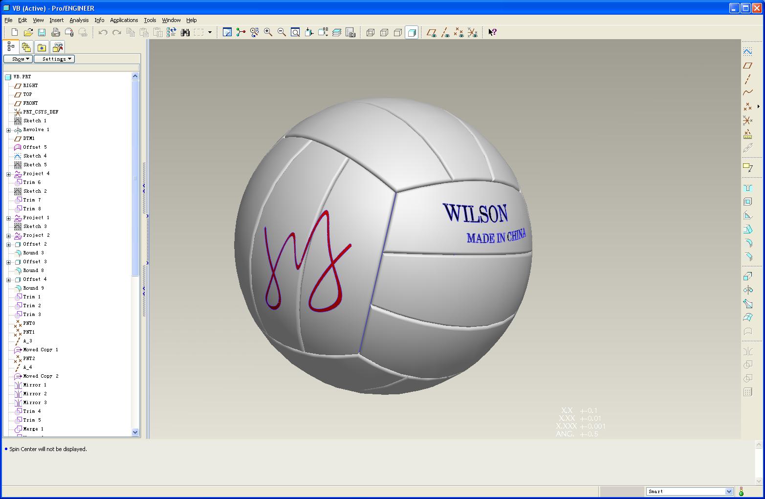

    THE VELLEYBALL WITH MY SIGNATURE

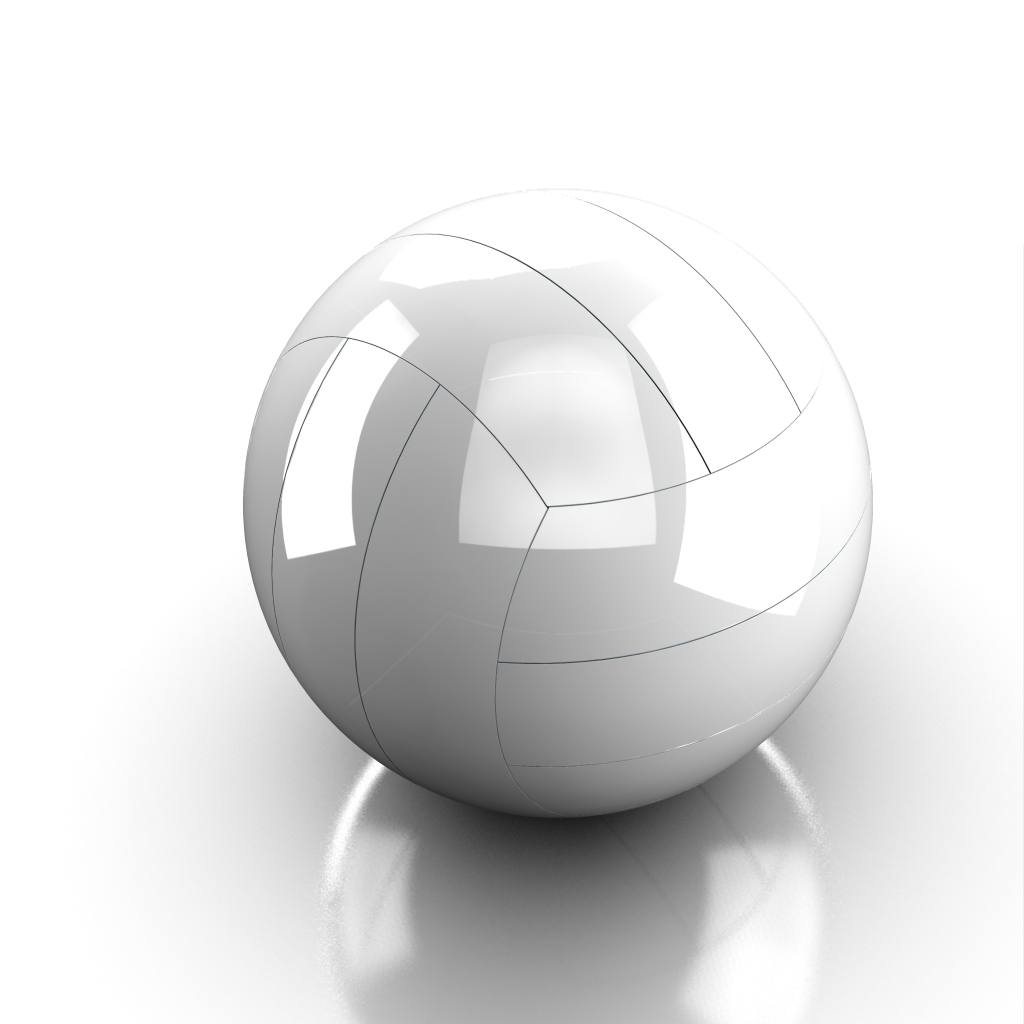

    here is my 2nd design. A Volley Ball. It is assembly of cut section part. I tried to model this before also but always stumbled upon the geometry of stripes.. those should look straight lines when seeing from normal views. Finally solved the whole geometry first on paper and then applied some magical angles and did that finally
    I will soon upload Video explaining the whole process.
    Sep 6, 2013 10:03 PM UTC
    This is an interesting challenge. There is not much information on how the three stripes are divided.
    Sep 7, 2013 3:08 AM UTC
    Okay, that was fun:
    Creo 2.0 full version attached
