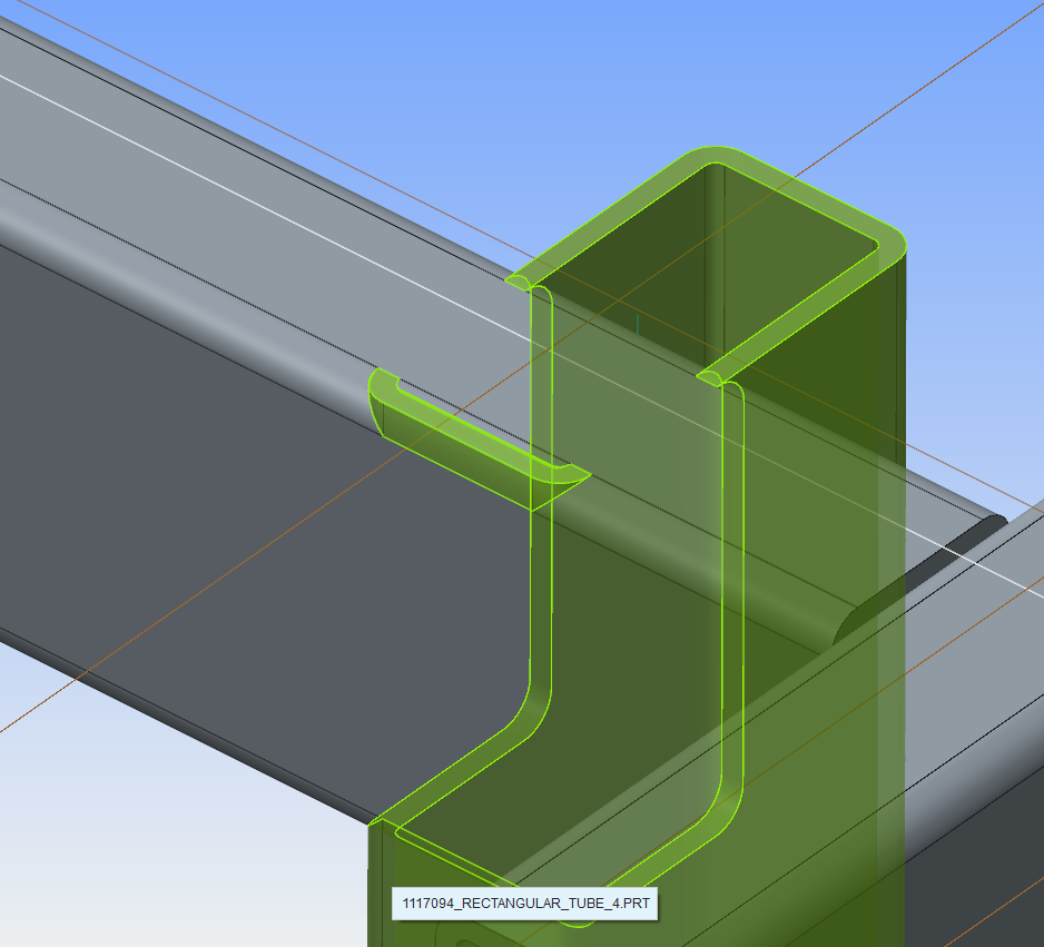

Does anyone know how to remove the rest of a frame when it has been cut using another profile?
I am using PTC Creo Parametric 2.0.
In order to clarify the question I am including a picture below.

    why don't you use the bigger profile to cut ?

    Well, I need to use that frame, not any other...
    Feb 9, 2016 9:01 AM UTC
    I guess you have used cutout feature. Remove it nad use common assembly cut (you can define its sketch using profile surfaces/edges and enlarge it to remove unwanted geometry).

    You are right, that is one solution, but I am searching for a solution inside Advanced Framework Extension to not to lose any of the advantages of this tool.

    in case of AFX I suggest you to post your question under Advanced Framework Extension - AFX group. I hope people from B&W Software GmbH - Solutions for efficient product design: Unternehmen will help you to resolve the problem.
