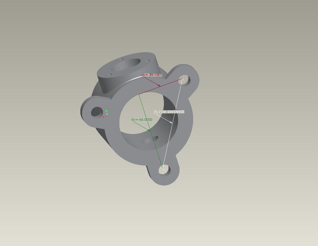

previously while using the measure option ( proe 4 or proe 5) i could do this, to get the measurement along coordinate system.

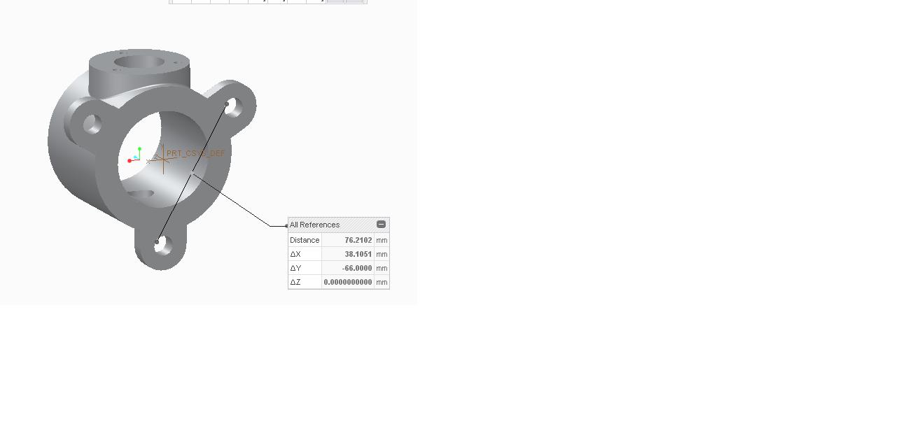

but know in creo 2.0 , it does not give the reference of x and y along coordinate system.
it just gives the measurement in a box.
    Feb 12, 2013 4:31 PM UTC
    That is what those delta references are in the dialog.
    It is using the CSYS projection reference from the expanded measure distance dialog box
    Feb 12, 2013 4:58 PM UTC
    thanx for the reply.
    i know those dimensions are shown in that box....but as you can see the reference line in the image from proe 5.....those reference lines are missing in creo 2.0...
    Feb 12, 2013 5:20 PM UTC
    True. I am not impressed with the new measuring scheme at all.
    If you use a datum plane as a projection reference, it will at least draw dashed lines to show what the reference is related to.
