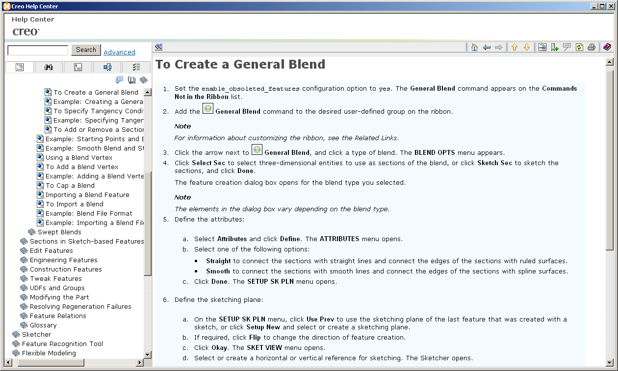

    General Blend has been removed from the blend options. you have to go to configuration editor and type "enable_obsoleted_features".
    then go to customize ribbon and select commands not in ribbon and you would find the General Blend option there.
    You can add it to a new tab.
    Feb 25, 2013 8:29 AM UTC
    see the attached HELP page.
