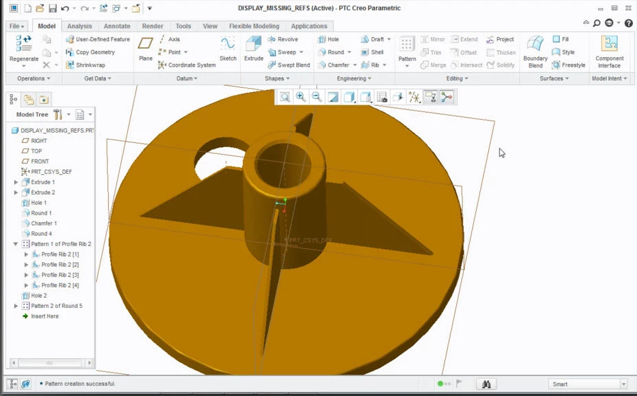

    I'm one who readily drinks the cool aid (Kool aid?!). I like the new UI. The ribbon appeals to me (I love Office 2010 and even 2013), larger icons for popular functions, ability to customize ribbon, better JLink environment settings, more rmb menus and model tree access, etc. I also have to say that the command search is a definite home run. I appreciate the learning connector videos. I know we can customize that as well. I have also enjoyed the changes to sketcher, too. There are some pretty major setbacks, though. Measure tool and integrated windchill performance are both abysmal. It did take a bit to get used to where the datums are, but that can be mitigated by putting the on/off buttons directly. So not saying everything that changed is tulips and roses or even well thought out.
    Overall, though, I like the updated UI. I even like that they've changed the background to white. Of course, it will be a different color in CP4 probably (ha!).

    I'm with Brian on this, and I'll add that the many changes that have been made to the sheetmetal UI have been nearly all significant improvements. In many cases there may be more mouse-clicks needed, but the greatly improved flexibility in the process is welcomed by me anyways. (I've been using it since 2002.)

    Anyway, I have used PTC tools since version 6. I would never go back. I too like the new interface. It took me a while to convert. Could some things be changed for the better, YES but I would not like to go back. I use to have 100's of mapkeys to help push things along. I remember the old contests on how many menus you had to push down to get to a function. ( I think that the winner was about 17 menus down) I also remember the old sketcher days. We spent almost a day on sketcher and how to get your sketch to regenerate. Now I never worry about that (do you remember all the hate mail over this one?)
    Lots of people will disagree with me but overall I think that PTC is going in the right direction. If you don't like it, find someplace else to eat.

    All in all Creo is a "better" evolution on many fronts. Being a "lifer" (Rev6 Vet) I have seen much from PTC over the years.It's safe to say it was free market competition from SolidWorksthat forced PTC to take a hard look at the GUI and functionality that resulted in Creo. There are some things that were overshoots in my opinion. The Creo colors are abysmal and terrible for old guy's eyes. My retinas have been in front of a CAD screen for 30 years and are wearing out. I know I can change them...but I get so busy thatI have not had atime to set it all up to a more "benign" interface. (If any old fellow geezers have created a pallet they would like to share, I am accepting charity)
    Cannot stand the pre-highlighting at times, especially when trying to change dim values in a model.
    I likeSimulate Lite (Thanks SW for the forced functionality). BUT....200 surfaces max? C'mon you stingy rats. Allow us the full hot order with Lite. It's already limited on many fronts so what sense does it make to limit the suface count?
    Reps are still too cumbersome for me....better but still a bit of drudgery.
    BOMS and tables...still too esoteric and cumbersome.
    Setting colors and surface textures went the wrong direction. WF4 was nice....I hear Creo3 has some goodies. I have yet to do actual work with shadows, rendering and background "On" so it's functionality I do not find useful.
    Mr. Doug Shaeffer will jump on me for this...but Configs are too confusing for me. The "Current Config" thing is something I believe is overkill. Keep in mind I am a Simple CAD Monkey and do not have Admin requirements. It may be nice for them but gets in my way.
    The sketcher setup assumptions are a hidden danger for Parent Child relationships. I Always, Always, Always make a point to verify my sketcher setup is the way I want it and not what Mr. Creo thinks I want. 9.9 out of 10 times it chooses a random surface as the orthographic reference I do not want. That is fundamentallyopposite to good Pro/E modeling robustness.
